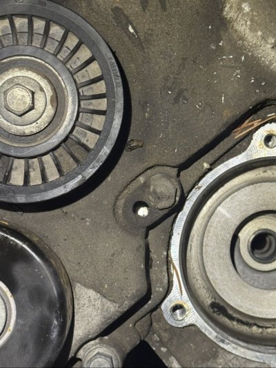

There is also a difference in the front of the block. Some older blocks don't fit our 3V timing covers quite right.
I'll dig for photo's that I know I have around somewhere that shows this.
DirtyDogOfTheDesert
Apr 18, 2007
1,001
12
Canada/Yemen
Okay here's my crude attempt at coloring in the spot I'm talking about. The 3-V timing cover gasket folows this contour in the '05 block. Earlier blocks don't have this little extra bit in the block, so using your 3v timing cover on these older blocks, without addressing this, will lead to a BIG oil leak. Just ask lostsoul!

Buddyw1964
Dec 29, 2025
Washington
100 percent thanks we swapped a engine out from a salvage yard for a drift car and had serious oil leak issues. The engine was built ported heads forged etc.. but was built on a truck block. Here are some photos showing this hole in the engine that came out of our2008 that we blew up and the engine that we put in. Hope this helps someone!! Was a bitch trying to figure it out for us.
You can see the block doesn’t cover the entire hole on the one we just put in. .
