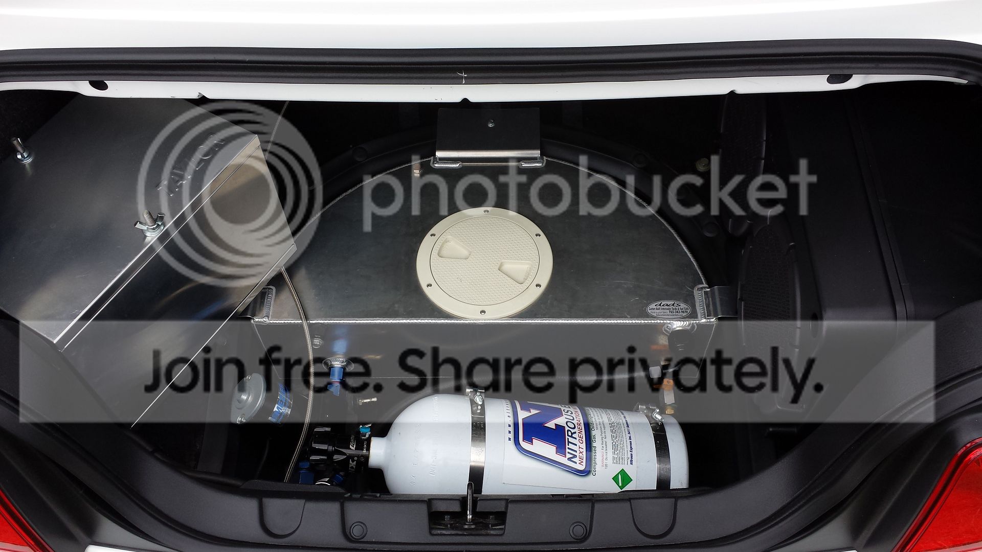

Tank reservoir...I think it was forum member "jew**" that has a tank that fills half his spare tire wheel well. I like that setup.

The pump really depends on the location of your water tank/reservoir. I currently have a custom "Dad's" tank in my trunk with a Rule 2000 bilge pump in it. It works well but something you have to consider is with a bigger tank, once you heat soak it, it takes much longer to cool it back down. I just purchased Jabsco 50840-0012 pump which I'm going to try and run in tandem with the Rule 2000 pump. Eventually I want to loose the big trunk tank and only have a small reservoir up front with the Jabsco pump.
If you want a big trunk tank I recommend reaching out to Dad's and discuss what you want with him. You give him dimensions and he can fab up whatever you want at a reasonable price. The in-tank pump will suffice initially but you really want a pump that can deal with some back pressure. It really all comes down to what you want to do with the car. I drag race so consistency and weight are very important so that is why I'm looking to get ride of the trunk tank. I want something that will cool back down quickly after a run and having 7 gallons of water/coolant getting warm takes forever to cool back off. If you just want it for glory passes and to stuff ice in it, then by all means the trunk tank is the way to go.

The trunk mount tanks only really have an advantage if you are at the drag strip and putting ice in it constantly. On a street car that you are using as a DD it only has an advantage until you heat all the water in the system up (which takes only a couple of minutes). Once you have heated all the water up all you are doing is hauling a bunch of hot water around. Yeah the tank itself will shed a little heat, but not enough top offer a performance advantage.
IMO there is no reason to have a “big” tank on a DD/street car.
EDIT: Forgot the link to Dad's website...
http://dadscustomintercoolertank.com/
I like my DAD's custom tank also. The Rule pump is a piece of crap tho. I have a ton of ammunition to support that claim also.. and personal experience. That is a bilge pump and needs to stay in a boat lol. If you drive a boat then by all means...
But.. The Meziere 20gpm is a winner and easy to install right at the tank
