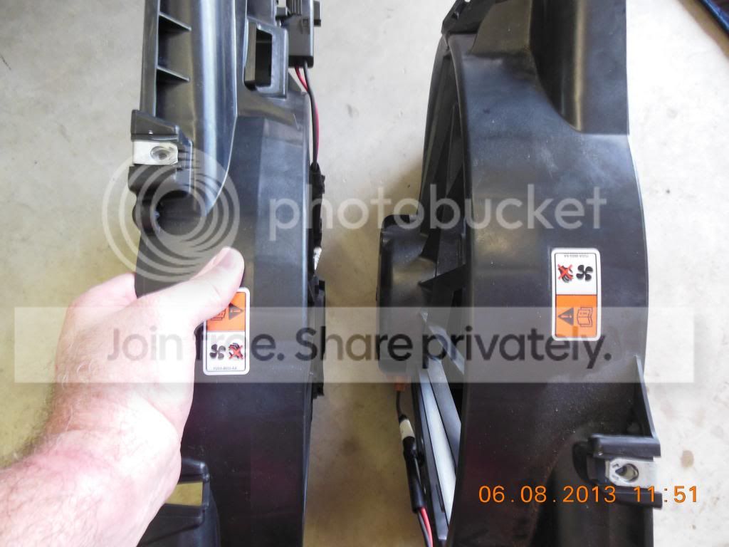

Here's some dimensions...
The 2013 GT 500 shroud (left) is 3.950" deep - .130" wider than the stock GT shroud 3.820" (right)

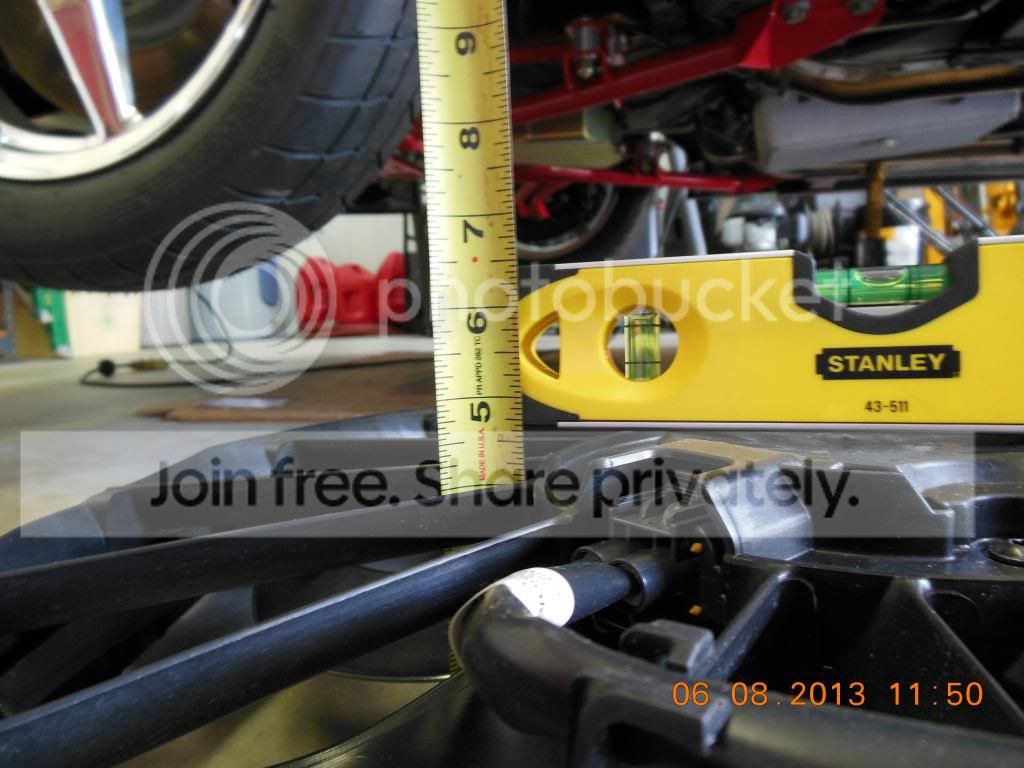

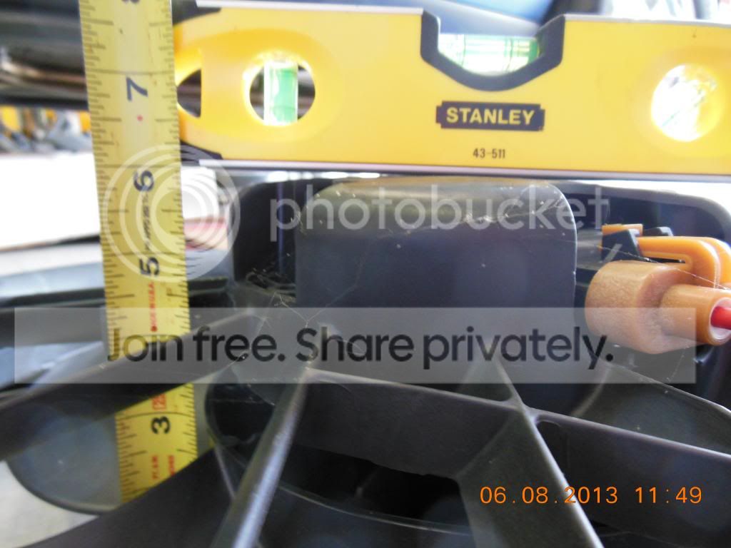

Here a comparison of the depth from the mounting face of the shroud to the end of the fan motor housing
Stock GT
2013 GT 500 - FRPP M-8C607-MSVT. 1.375" narrower than the stock GT Fan assem

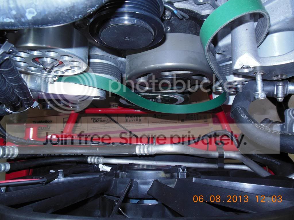

Installed
