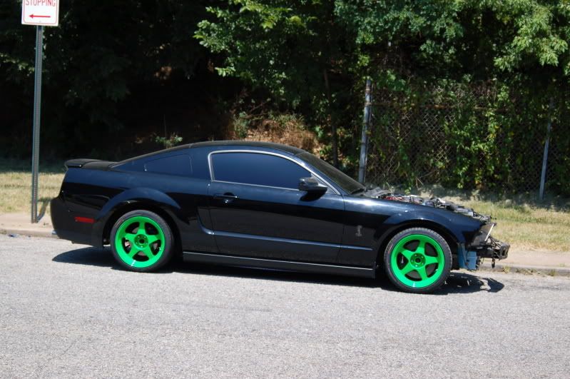

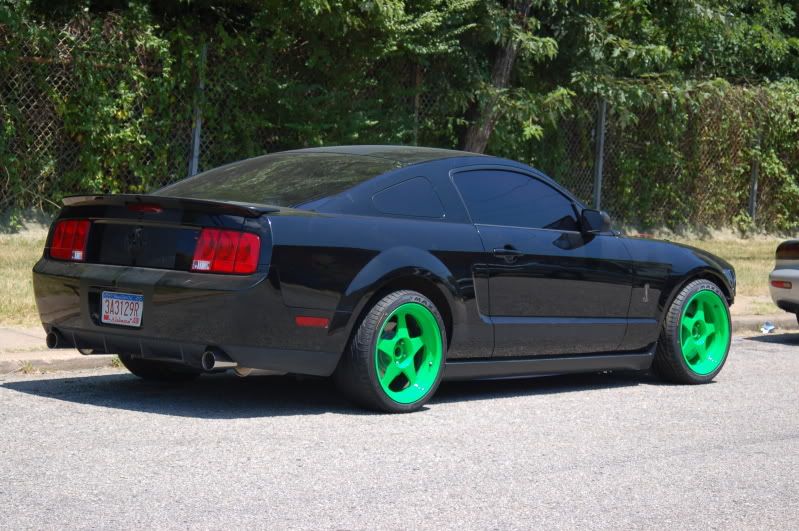

Now on to the mustang. The car i got was a 2008 Mustang GT with an auto trans. I got a great deal on the car as it was missing some parts and i couldnt get much info on the history of the car. I dont care much about its history though as i planned on just taking it all apart anyway.
Here is the car as i got it...
It was pretty much a bone stock low mileage GT with brembos and some missing body parts. I of course bolted my wheels to it right away, haha.

Hey thanks guys. The wheels are right off my Nissan. I have always loved the basic wheel design and got bored of the polished look they had previously.

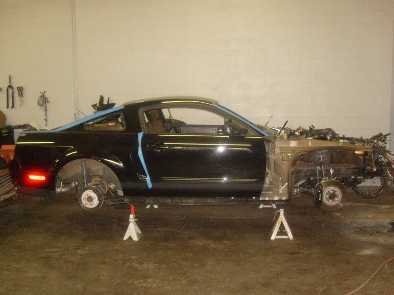

This is how the car looks as of now...
Up on jack stands awaiting some base plates and cage work!
all the front end removed. Pretty sure im going to put a 2010 front end on it. Hopefully i can get those parts sooner than later.

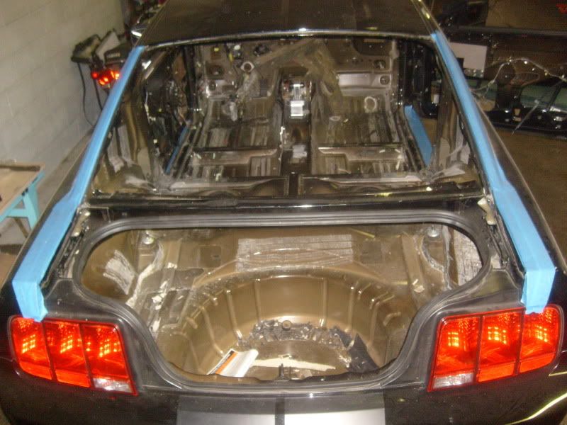

here she is again. I cut the rear "speaker deck" out to save some weight. Ill be cutting out a few more things, but not much due to the Formula D rules.

great project! what brand wheels are those? I actually love the green. Be sure to visit the offical weight thread for ideas ;)

the wheels are made by a Russian company called Desmond. This particular wheel is known as the "regamaster". Its a super light weight forged wheel. Sadly they are no longer in business, so they are hard to come by.
The sizes on these particular ones are 18x9.5 +18. Ill be purchasing 4 more that i just sold, back from a friend of mine.
