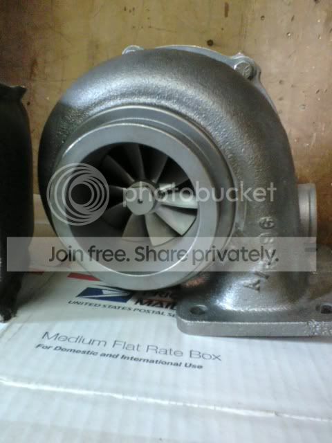

Some pics

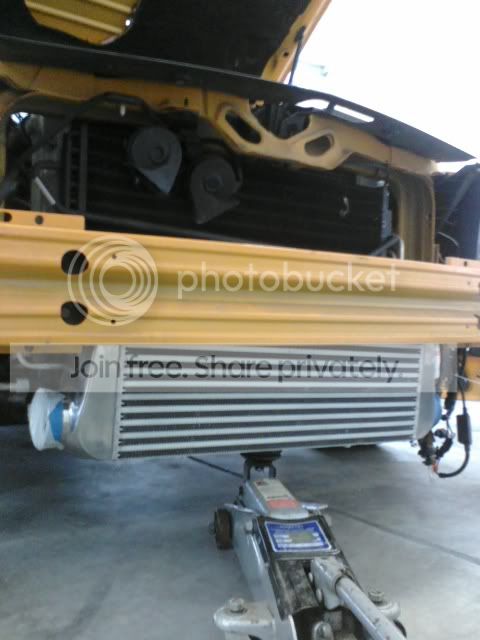

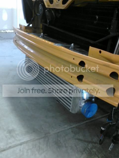

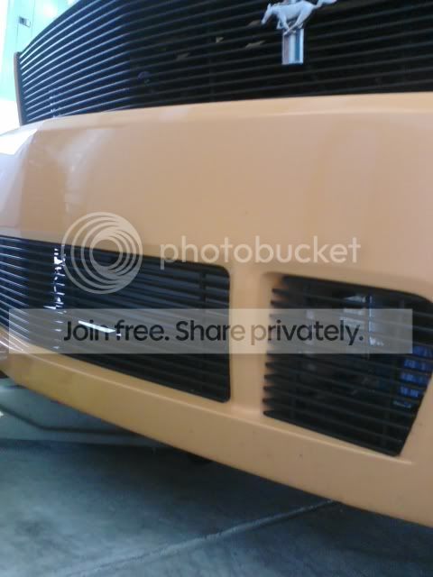

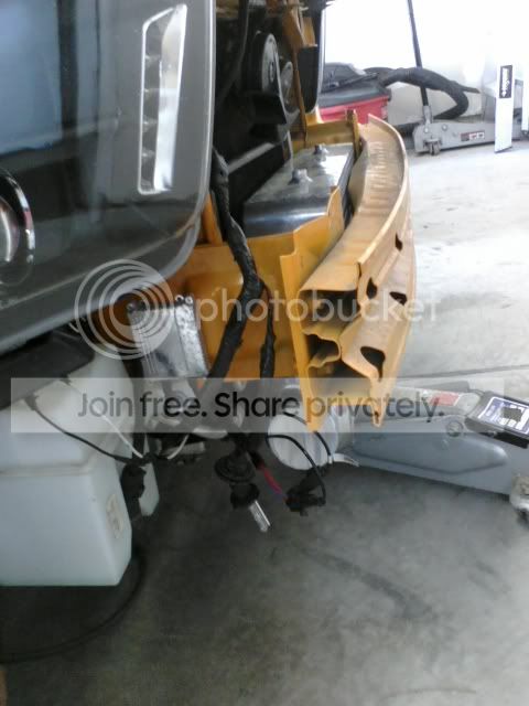

Intercooler mock up and install is done with the help of greg :)
Pretty staright foward thought i was going ot have to cut the bumper beam but turns out the intercooler fit ;)
Put some pipe insulating foam on the ac line behind it so it wouldnt rattle on the intercooler. Fit like a glove nice and snug and secure!

Thanks guys, hey billy im guessing i didnt have to cut the bumper because of no tranny cooler, arent u auto?
Yes I am an auto . I didn't have to cut it , I just didn't like it sitting so close and the bumper being there the air flow is much less then with it done the way I had it . It should work fine the way you have it though.
gotcha yeah the roush bumper def helps let air in
