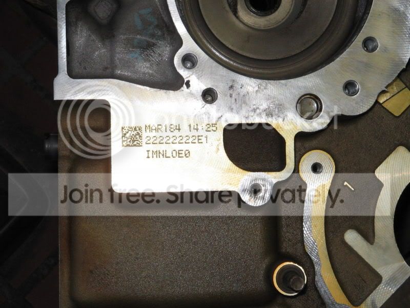

The seller told me it came from a 2004 Mach 1. The main caps look identical to a 3L, the part number even starts with 3L. The sleeves are relieved for a 4v. It was built on Mar 14 2004. The motor mount bosses look the same as my 3v.

The cast date on mine is MAR 112 2004, so ours were built real close together. I haven't pulled the stock short block out of my car yet so I dont have anything to compair the main to. On your 1L2E block is the main caps about 3/4" thick and the edges rounded instead of squared off? they just seem........dinky to me for some reason.

Looks just like my 3L2E caps. The pic is of the 1L.
Here's the build info. I had the date wrong.
