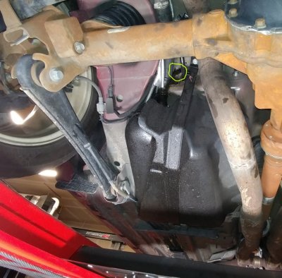

My car has had the hose and plastic valve fix since new, or since slightly after new when I took it in for the leaky diff. The hose goes from the left axle tube and is clipped to the gas tank strap right up against the floor pan. I didn't think the turkey baster would be big enough to contain the fluid, but that was before I wondered if the vent valve might be stopped up against the floor pan. Maybe I should have tried the bulb, but the spendy parts will be here tomorrow.
If the photo uploads, the green circle is around the end of the vent hose. It's crammed in the corner up against the floor pan. There is the usual plastic valve on it. The pink arrow points at the clip on the gas tank strap that's supposed to be clipped to the top of the diff housing. It's a greasier mess than the picture indicates.

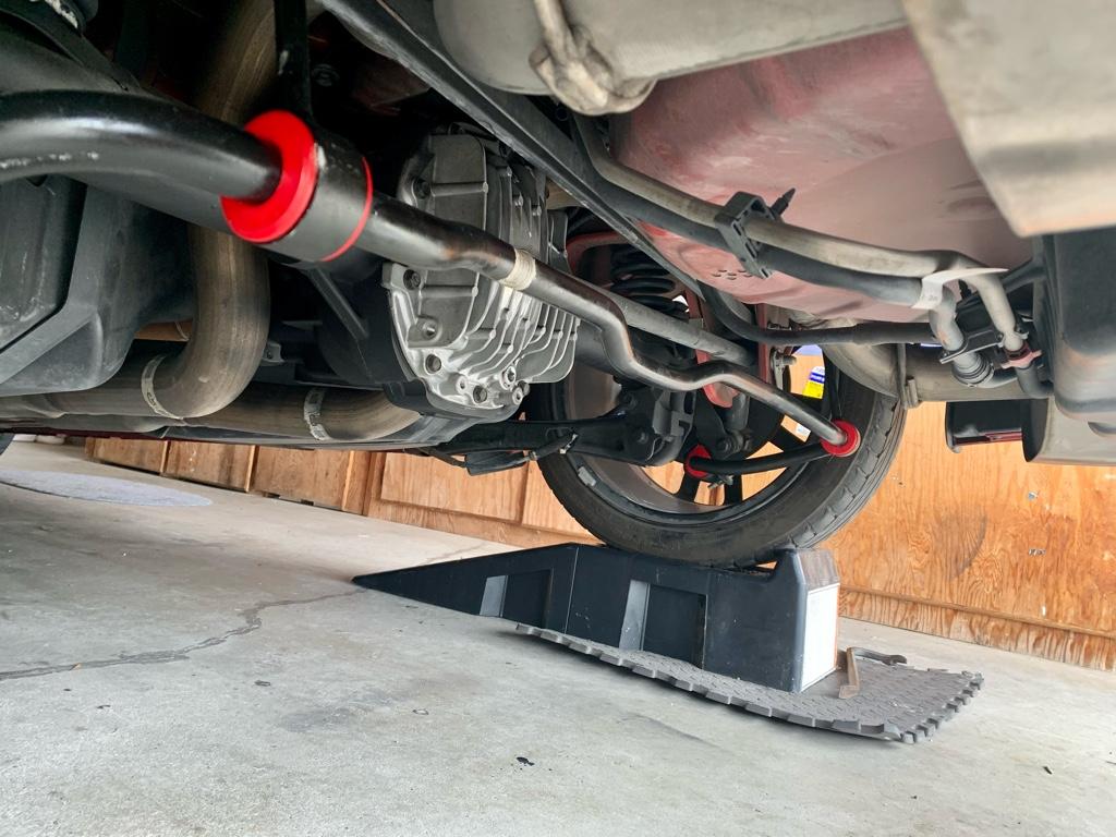

The finned cover and moving the vent to the top of the cover is the best and simplest solution. No catch can, no vent hose, and no leaks open tracking/HPDE. Looks good, provides diff cooling, and easy drain/refill access. I was toying with the catch can idea, but the cost of those was dickriculous.
