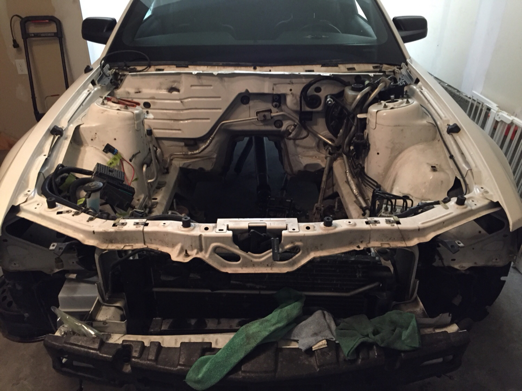

Engine out.
Ready for new home

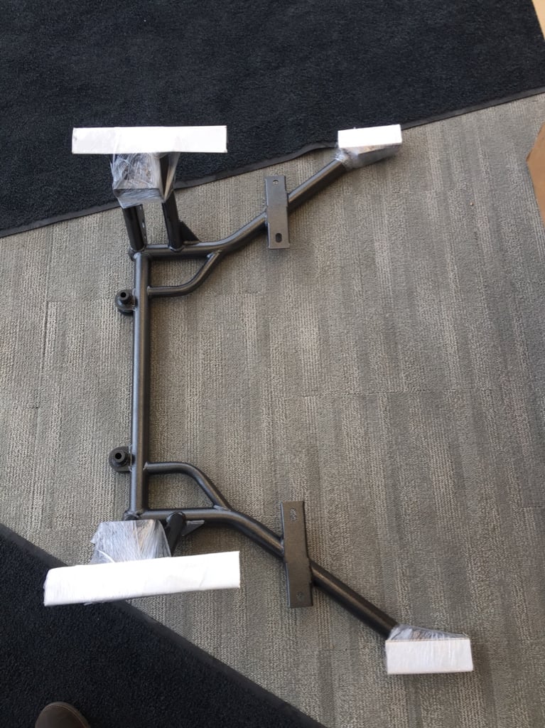

Got a little bonus at work, and the engine is out so I figured a BMR K member was in order.

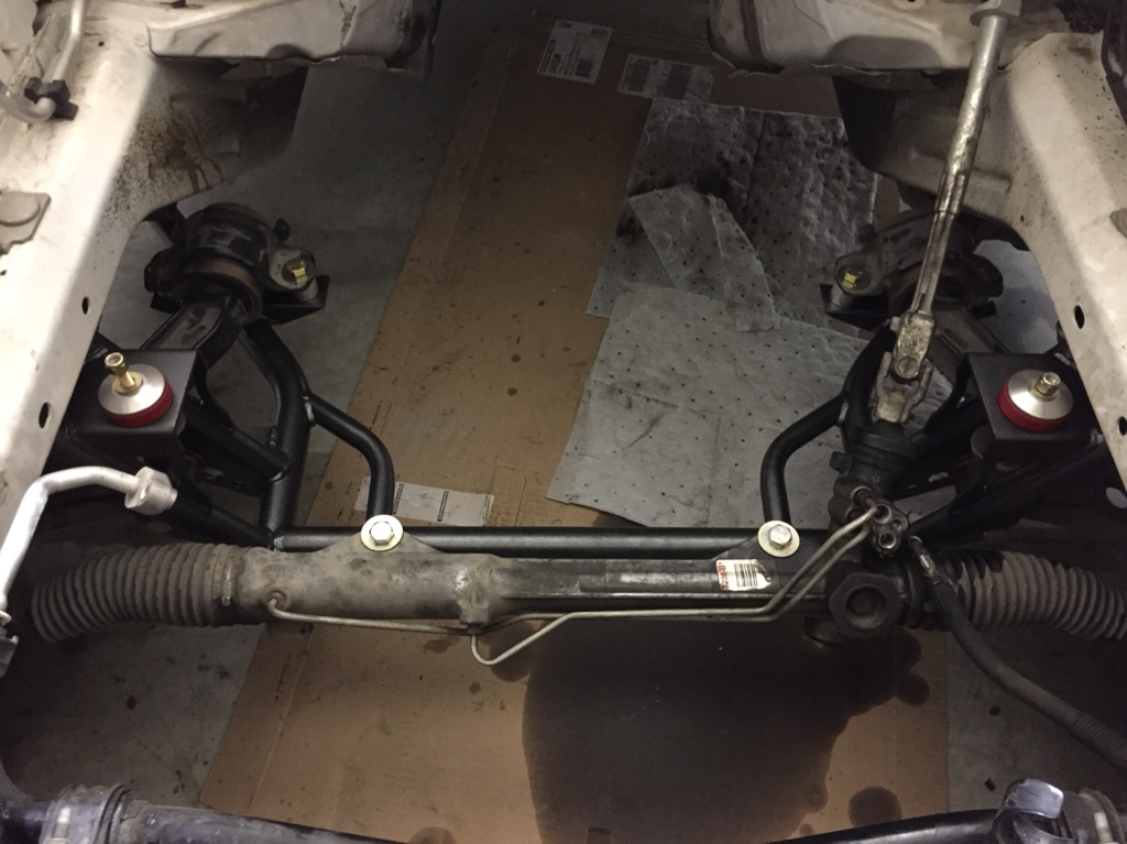

K member is in - it was a pain even with the engine out. Ball joint fought us.

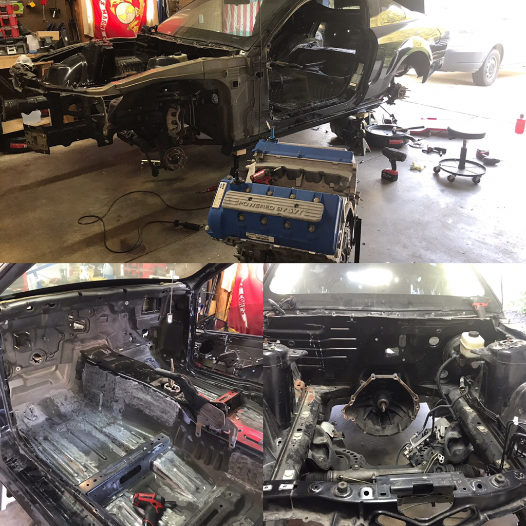

GT500 engine and transmission are out. Should be back in the GT tomorrow if all goes well.

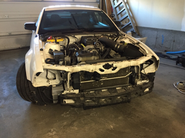

Got more work done last night, AC Condenser, radiator, heat exchanger (factory H.E. is TINY!!! Ordered a VMP triple pass dual fan unit) fuse box, PCM, fuel lines power steering.
Next up is exhaust,O2 sensors and wiring in the IC pump. Might have it running by the weekend, but I’ll need the locksmith to come over and program my PATS keys to the new PCM.
Project is going smooth so far.
I also ordered an MGW GT500 shifter as the factory unit is really flimsy looking and I loved my MGW on the 5 speed GT trans.
And I ordered a Ford Performance 1 piece aluminum driveshaft, Metco driveshaft loop and Ford Performance hood struts...
Budget has officially been blown.

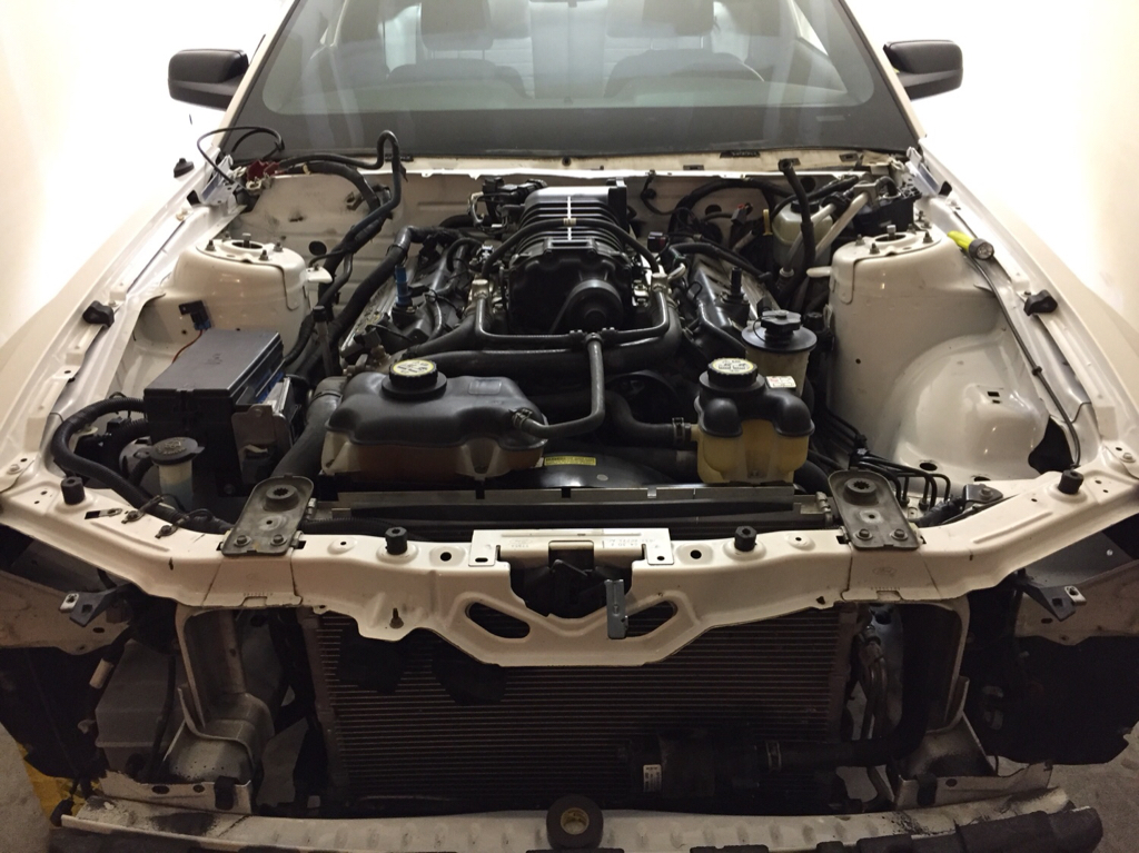

white_lightning
Mar 30, 2010
219
Calgary, Alberta
Keys got programmed today. And it fired first go! I seem to have a TCS light on but no other lights on the dash. I also seem to have a belt issue as there was quite the squeal on start up and no it’s not the blower. Lol.
