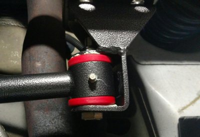

Installing the BMR Watts on the fiancee's Shelby and having interference issues between the rear swaybar and the Watts.
Swaybar is factory piece, factory end links too.
How can I fix this other than removing the swaybar or replacing the bar/links assembly?

Is the suspension hanging while you're doing this? That was a problem I was having back when I was attempting to install it. Put a jack under the diff and raise the axle up a few pumps. Should leave you adequate room still to work.
It was hanging.
Like I posted above though, I flipped the bar side-to-side and got plenty of clearance.
Only problem I still ended up having was the driver side bracket that the link goes into, was not welded right.
With the link in it, putting it up against the axle clamp piece, it wasn't anywhere near flat against it.
Had over 1/4" of space on the inner side.
Took the link out of it, bolted it up, then hammered it back so the link bushing could actually fit.
I still don't like how it fits around the bushing, hoping for a replacement ...
