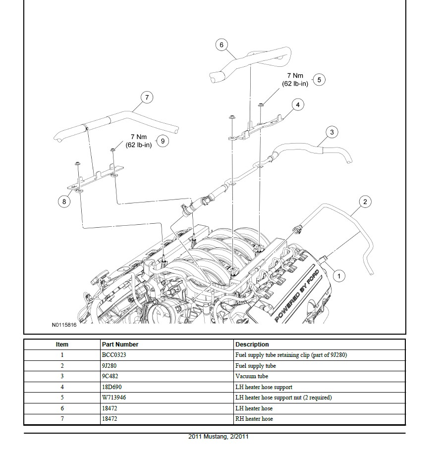

So far, this is what I have. What I really need is routing for brake booster.
There is a port on back of manifold, but it looks large for the brake booster tube.

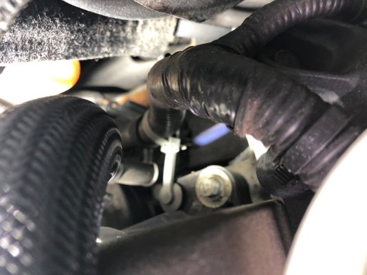

2014 GT auto, stock except for FPP oil separator on the passenger side and Steeda CAI. This is the driver's side PCV, albeit with a Steeda CAI. Even so, this is the stock hose and the location should be similar on the stock airbox. Can't see much on top or at the rear due to the engine cover. I will take the strut brace and engine cover off tomorrow and get you some additional pictures.

Thanks a bunch!!! I found more pics I will add here, but one that I am still not sure on is a port on the back of manifold. Any chance you can take a look for me there?
