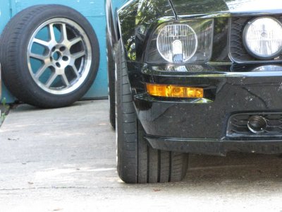

Back to wheel sizes. I haven't picked exacts out yet. I know I would like to look at forgestar or apex offerings. If their 18x11's would fit I'd be game.
I am running the Forgestar 18x11's, with 285/35 MPSS tires. Up front, it's tight but entirely doable.
