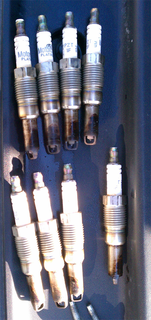

So ill share how I did it on the 06 3v. I know everyone has their own technique but i thought that i would share my own. When i got off for lunch at work, i drove home and got it fully hot. I loosen the spark plugs until they started catching. Then like the ford TSB i sprayed PB penetrating oil on top. I went back to work and let the let it sit for about 2-21/2 hours. Then loosened them a little more until the started catching and almost stopping. I then tightened them all the way back in tight. After i started to remove them again their was a lot less friction and all of them came right out. Replaced with brisk plugs for the turbo and im about ready to get tuned. after i got the plug out i wiped them and that pb penetrating oil made the oil and carbon wipe right off those plugs. as you can see on the bottom plug in the picture. I swear by this stuff.
Hope this helps you guys. Other thing i made sure to stay straight on the extension and socket.

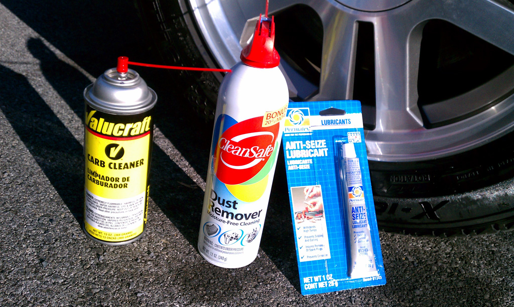

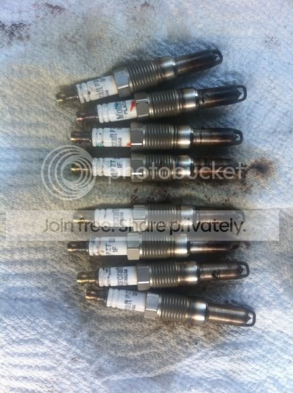

My 2005 had between 55,000 and 56,000 miles on it when I changed the original plugs recently. The Ford tech video someone posted a link to on here said to remove the plugs when the engine is warm, but not hot. All eight of mine came out in one piece too. Here is how I did it:
1. Drive to the auto parts store, get new plugs, carb cleaner, anti seize, and drive back home.
2. Park car and let it sit with the hood up for a little while.
3. When the valve covers are no longer hot to the touch, take off the coils, spray compressed air into the plug holes to get out the dirt and dust, loosen all 8 plugs 1/8 to 1/4 turn, and spray carb cleaner into the holes where the plugs are until the carb cleaner is deep enough to reach the ceramic on the plugs.
4. Go in the house and eat lunch. (a.k.a. let the plugs soak for 30 minutes.)
5. Tighten each plug 1/8 to 1/4 turn, then try loosening them. Four of the eight came out easy at this point for me. They made a little noise, but they didn't have much resistance.
6. Any plugs that didn't come out easy, respray the carb cleaner in the holes and let them soak at least another 30 minutes.
7. After letting the plugs soak, try tightening and loosening them 1/4 turn in each direction, then try taking them out. At this point, the remaining four came out. They made noise, but didn't offer much resistance. If any were difficult to take out at this point, I would have resprayed them with carb cleaner and let them soak longer.
