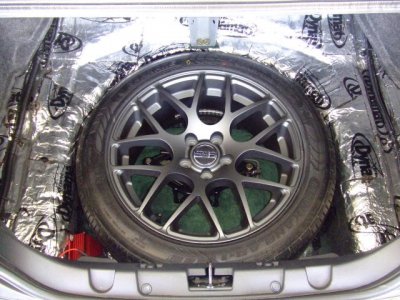

Here is a quick rundown of my Brembo full size spare project. Ordered an AMR 18x8 wheel and a 225/50/18 tire. I run 285/40/18 on all four corners, and the 225/50/18 is almost the exact same diameter. With this set up, it fits in the spare tire well at full air pressure and only sticks up a bit over the trunk floor. Also finally put my TSW Nurburgring's(18x9.5) and Nitto 555's(285/40/18) on the scale: 55lbs. The AMR full size spare is 51lbs.

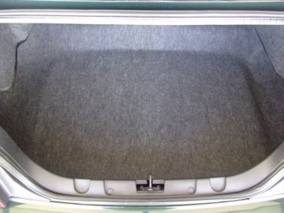

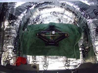

Here are the pics that are missing above from the install on my 2008 Bullitt. Crazy I started this thread 6 years ago.....
