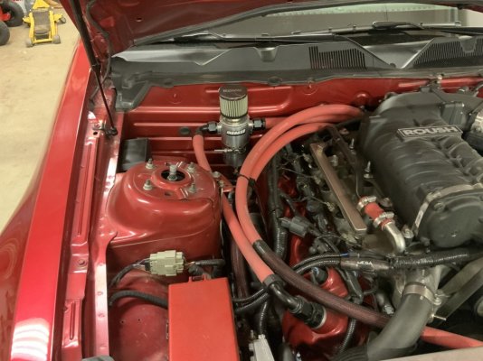

I am using a Moroso dual inlet with breather type catch can. It is connected to each valve cover. There is no PCV valve and no connection to the engine combustion air system. It works very well. No oil is drawn into the engine through the intake. No oil is forced out of the crank case through gaskets or seals and no oil has shown up on my firewall. I have drained a few ounces out of the can at oil changes. 2,500 mile intervals.
