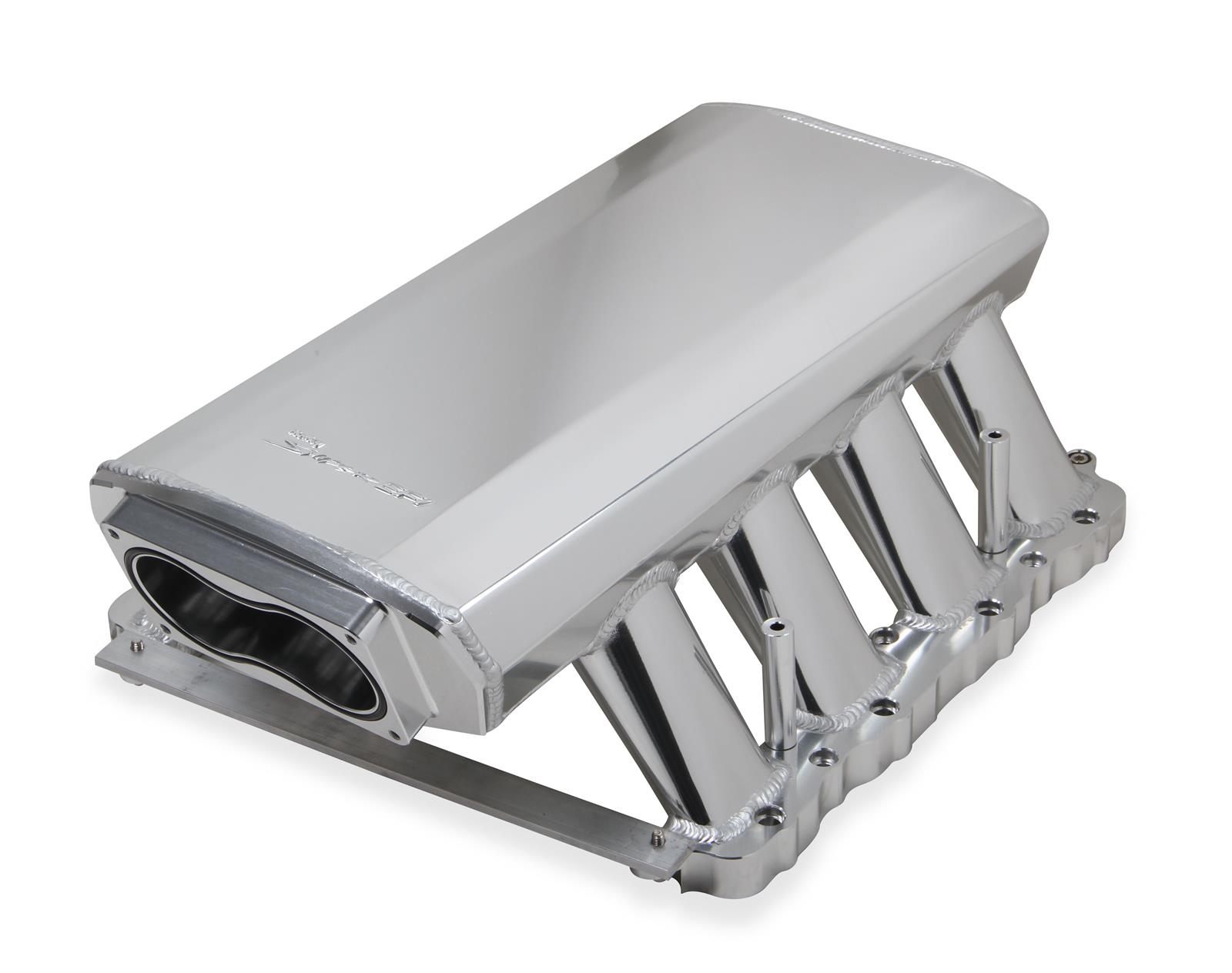

Is this the intake manifold you're referring to?

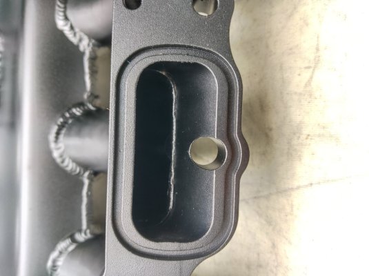

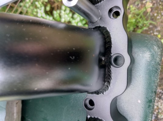

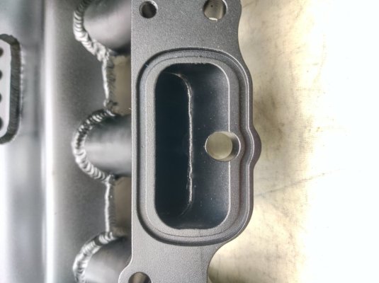

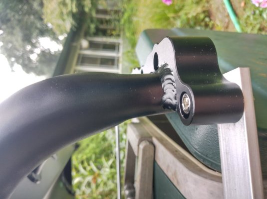

ok here are pic,s. the ones from bottom are square to manifold showing what head port actually sees. a severe restriction and a severe angle of airflow.

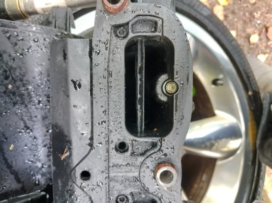

Just for reference this is a Ford flange. Full size straight shot. Ok I guess this settles it. It's going back. I thought I would buy this and use it till fall, then put 3v 5.4 in over winter and just widen manifold by simply adding width to tubes at plenum. With bottom of tubes being so bad I would have to completely rebuild them. I was hoping for someone that has purchased this to chime in. They (summit) sure took the easy way out.
