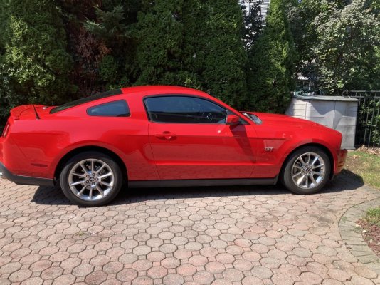

I recently bought a 2010 GT 4.6 with a Roush Supercharger and before making some mods interested in how much I can HP I can safely add. Also interested in going from 3.31 gears to something like 3.73 or 4.10 any suggestions. Thanks

Welcome from Florida.
Post some pics of your S/C Mustang.
