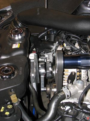

I Don't have the belt flying off problem/tensioner breaking problem on my KB car :)....
