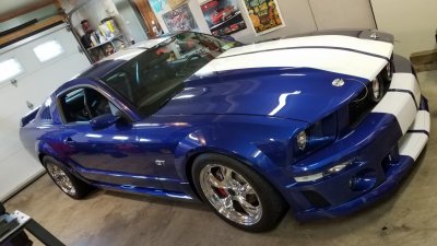

20181124_205057.jpg I know it wasnt one of the options you listed. But I have a VIS Racing carbon fiber hood. Its lightweight and heat removing. They are costly but I love it.

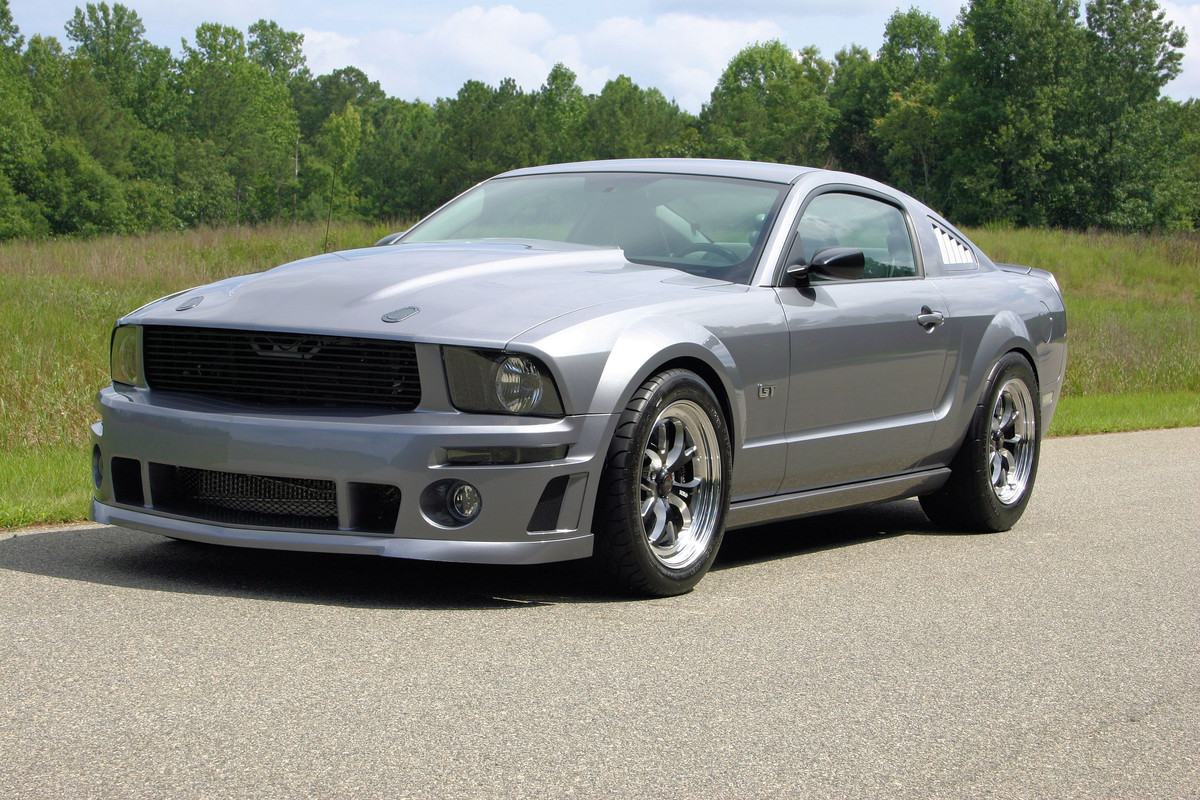

This is the Steeda race hood with AeroCatch latches.
Ah that looks good. Is that your car?
If so, how reluctant where you to go chopping on your new hood to put the Aero latches in?
Kinda a one shot deal as you get one try to get them right.
Did you mount the pins where the rubber adjusters are?
Can you provide any pics from the underside of the hood where latches are placed.
Thanks :)
retfr8flyr
The Old One
Apr 7, 2007
7,193
108
Providence Forge, VA
Yes. this is my car. I wasn't reluctant at all. I had the Drake hood pin kit already installed, just got tired of the cords, so I used the mounting tabs from that to mount my latches. The car is in storage now, So I can't give you any underside pics. The Steeda hood and I guess any glass cowl hood is two pieces in the area I mounted mine, so the latches are mounted just to the top of the hood and the underside us open. One thing about the Steeda hood is it is reinforced in the main latch area and I still use my stock latch with this hood. The AeroCatch latches are just for extra protection.
