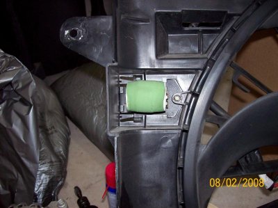

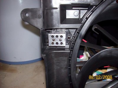

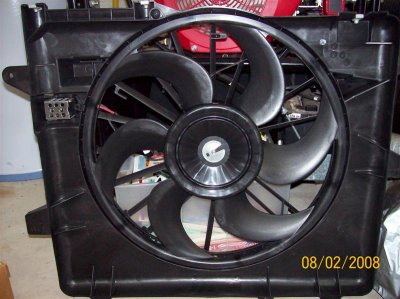

Just thought I would share some information about this new fan assembly. The fan, motor & shroud look identical to the 2005 assembly. What is different is the resistor. This is the same resistor that Thump_rrr said was in the circuit but not shown on the wiring schematic. The resistor is mounted to the shroud where the harness plugs into the assembly. The resistor is for the low speed side of the fan only. The resistor has 3 wires coming in (low speed from the relay, high speed from the relay and a ground) and 2 wires going to the fan motor. The resistor is not serviced separately. The fan motor speed is controlled by the resistor. When the resistor fails, the low speed side of the fan does not work. Take a look at the attached pictures. Looks like the resistor for 2007 (silver in color) is definitely changed from the 2005 (green in color).

Looks the the resistor for 2007 (silver in color) is definitely changed from the 2005 (green in color).
They've added ventilation. I bet the one you show in green gets red hot and burns up because it can't cool off enough. All of those holes and such are for one thing: air to circulate!
