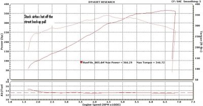

Dyno testing of the MMR CAI is complete and the results are dissapointing to say the least. ALL DYNO PULLS WERE DONE ON STOCK TUNING. Airfuel measurements were taken post cat with a wideband.

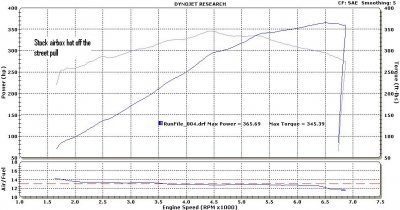

Hot off the street with the stock airbox the car made 365.69/345.39 SAE, stock tuning. Backup pull 5 minutes later 366.31/346.72.

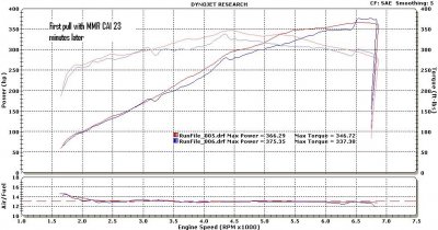

23 minutes later after installing the MMR CAI..... 375.60/337.30 but those hp numbers are misleading. When you see the graph you will understand why. The car is down on power thruout the entire pull and there is a spike at the very top that gives that max hp number. Tq is incredibly down with this intake the entire pull.

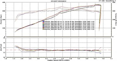

Backup MMR CAI pull 5 minutes later 370.54/329.05 with the exact same spike and down on tq. The backup pull to that one is identical.
Spent 5 minutes putting the stock airbox back on and got.... 368.53/350.57 and the spike was gone plus torque was back up 20.

I have attached the graphs with as much information on them as possible. Now its on to the next product to test and to continue our WMS Custom tuning that we started immediatly after the CAI test today with some very promising results that will be posted later.

In the interest of accuracy, in my OPINION the lose in power is not due to the CAI. The lose of power is due to torque reduction that is unrelated to the CAI swap.
I just spent the last 2 days on our dyno logging and tuning a 2011 and I saw the same power lose on a stock tune and stock airbox. It did not happen everytime and I can not say exactly what is triggering it, but I will. I verified with the logs that the throttle is closing some in that area. I'm no MMR fan but just thought I would share what I learned over the last 2 days working on one of these. There is no way a flow issue would cause such a steep step in the graph. My graphs look exactly the same.
And just to clarify my position our test car has not ever experienced any kind of power loss during any of its "totally stock" dyno pulls. Its been on the dyno twice with atleast 10 full pulls totally stock with no decrease in power save the heatsoak. The three back to back pulls with the MMR all had decreasing power and tq. I agree that something else might be happening here with the throttle but so far it is eluding us as it is Ken. I will continue to test this CAI as we learn more about this calibration, however I will stand behind my initial results. Just bolting on an MMR CAI for this car does not give you the advertised "no tuning required" gains.
There were no leaks or anything wrong with the installation of this CAI today, I followed the instructions closely and made sure my installation looked just like what was in the pictures. Considering MMR never even released a dyno sheet proving their gains I am highly skeptical that this was even tested to begin with.
I am also of the mindset that this is some kind of flow related problem and if you dont believe me Ken, take the air filter out of the stock box, put the lid back on and do a pull on your test car. You will quickly see what I mean. I tried that today for the hell of it and the car will not even accelerate so flow thru the housing and how its directed does make a difference.
