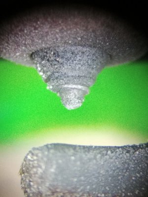

I took one out to look at it today. The electrode was rounded, and there was some sort of splatter on the curved metal piece that forms the gap. When I look at new ones, the electrodes are cylindrical and flat. I plan on keeping the car forever, so $40 for new ones is ok. Although Iridium is tempting, but may just be a gimmick. My last snowmobile ran better with Iridium for sure.

Can you post pictures of the spatter on the ground electrode and is the spatter on all of them?
I’d suggest stock replacements. Check the gap, and I always put a “very small” amount of never-seize on the plug threads.

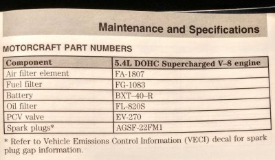

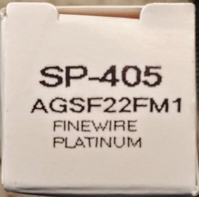

Ok, this has turned into some spectacle. I can't get a straight answer from 3 different Ford Dealerships here in Washington. The parts department says the gap is not listed in their computer system. The service advisors did not know either. One referred me to their technician. He says .033" ~ .037":
All did say that the Ford Motorcraft Platinum are recommended and listed as SP-405.
When I checked with Autozone and Baxter Auto Parts, their systems show .044"
I had them pull 2 separate manufacturers sets, 1 from Bosch and Autolite...their gaps are .044"

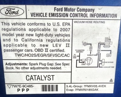

So, another technician says to look under the hood at the emission specs.

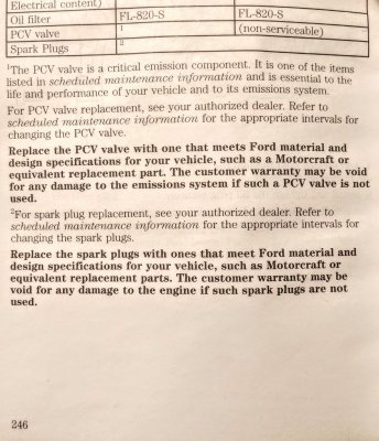

Here is the actual sticker... it says, "See Spec Book", so I go to my spec book...it says AGSF-22FM1, which are the ones that I have. (see actual box spec). When I go to the Spec page 246 in the actual owners manual, it says see paragraph 2: "For spark plug replacement, see your authorized dealer.
I already put in the Motorcraft SP-405 @ .044" gap. Seems fine.
Should I take them out and re-gap to .037"? I have read that you should never re-gap thin wire platinum, because it is brittle. I am at a loss...
You can see my original plugs, both the electrode (rounded off), and the inner smoothed contact area. (In my opinion, should have a platinum disc on that area)gt500 emissions 1.jpg gt500 motocraft info.jpg gt500 plug electrode 100k.jpg gt500 plug fire dia.jpg gt500 spark para 2.jpg gt500 spark para 2.jpg gt500 spark spec.jpg

0.044" is stock but is on the high side for a boosted motor.
If you are running it hard or taking it to the track, or adding more boost, I'd try 0.035" but if you are just wringing it out on the street from time to time and are at stock boost levels, 0.044" is just fine.

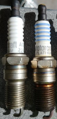

The stock plugs have blue painted rings on the ceramic ribs, the new plugs I got do not have the blue rings. Why is that?gt500 plug blue and white.jpg

Looking at that plug you need to run a better quality fuel.
The plugs have 105000 miles (20k were in Europe) But, always 92 or higher octane. Here in the Pacific Northwest, most gas has 10% ethanol. If I had the money, I would do 4 separate dyno tests, 1 with ethanol and platinum, 1 with ethanol and iridium, 1 with non-ethanol and platinum, and 1 non-ethanol and iridium.
