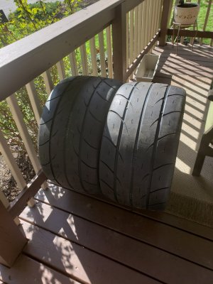

Alright, I just ordered two MT 305/35-19’s.
What pressure should I run these? Everything I’ve read gives mixed opinions. Some say 30-32lbs, others say 20lbs or even sub 20.

what sort of driving do you do?
I've found 28# works well in my M&H - obviously a different tire. The higher the pressure the better they will ride/wear

nice thing about tire pressures... you can adjust them all you need until you find the right balance and it not cost you anything....
I'd start at 28 and work lower if needed for traction.
