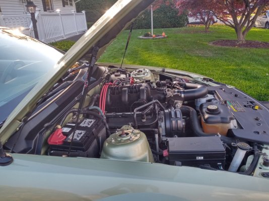

Oh, I just put a set of Redlines on and they work great.
Mailman
Mar 12, 2022
65
17
Fingerlakes, NY
Easy install, they work as advertised, and they really open up the engine bay without that stupid rod in the way. Got them through Amazon with C-card rewards. Nice!IMG_20231027_162428.jpg
