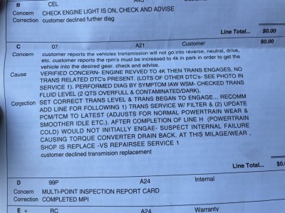

Well.. today it happened again, also got the CEL with 10 codes.. and the wrench icon too... I’ve given up... I ended up taking the car to my nearest Ford dealership.. let’s see what they have to say tomorrow.. :(

Just got off the phone with the Ford technician, was told that the car was driven 7 miles and that the transmission performed great and didn’t noticed any shifting issues.
Lastly, they did acknowledged that the car has an intermittent issue after the car has been sitting for a wile, it won’t go on R, D, they checked the trans fluid and was told it’s overfilled... 2 quarts overfilled to be exact, so for now, they are recommending a full flush with new filter, and a computer re-pogram for $600..

"they checked the trans fluid and was told it’s overfilled."
Wonder how that happened.... We'll, I'd forego the "computer reprogram" (wasted money IMO). Have them change the oil/flush/refill, change out the trans filter and call it a day. Then call AJ1E; describe your symptoms and see what they have to say. I spoke with them yesterday and feel they're very knowledgeable and well experienced on these transmissions. They didn't try to sell me anything and they mentioned other items to look at that may be more of a concern in your case.

Unfortunately it’s not the solenoids caused by dirty oil, after hours of research and taking it to a transmission shop for a second opinion, it’s turns out it’s got what many gear heads refer to as “morning sickness”.. basically when the car sits for a long time, the fluid in the torque converter drains back to the pan.. on a normal healthy transmission this doesn’t happen, and on transmissions with a godly amount of miles the drain back is very minimal almost non existent.
Now this 5R55... unfortunately it’s has (according to the guy at the shop) a worn pump bushing, allowing too much air into the system therefore draining the fluid off the torque converter, so when I try to put the Mustang in gear it slips, since it’s full of air instead of ATF, That’s why when I rev the engine it engages since it forces the air out and fill the converter with fluid again..
At this point I was recommended a rebuild not a complete overhaul, new clutches, seals, and a new pump assembly to remove any metal material that might be left.... at a cost of $1500..
