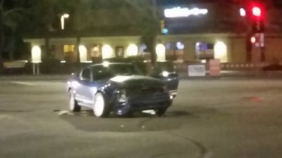

After getting t-boned by a red light runner on the 31st of July things are finally wrapping up with the insurance and I am looking at getting a 2012 v6/stick with roughly 61k miles on it. Are there any sort of maintenance or mechanical issues I should keep an eye out for? The air bag recall procedure was already taken care of. I should have a few "pony bucks" left over and would appreciate ant recommendations for some bolt on upgrades that will make things just a bit nicer since the car is totally stock.
Attached picture for those who would like to wish my 06 farewell.

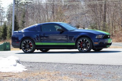

I bought a 2012 V6 with the Performance Package new and never looked back. The car has been amazing and gets better with every mod I put into it. The car cost me 28K out the door in Canada and now I have 190,000 kms on it(it was my daily driver for the first 5 years). To buy a base GT at the time would have been at least 42K. Basically the performance package gives you the same suspension and brakes as a GT without the 5.0. Since new it received a cold air intake, 73MM throttle body, BBK short tube headers, Ford Racing X-Pipe, Magnaflow Cat Back and a tune. Also with the performance package Ford set it up nicely with a 3.31 rear end, strut tower brace, GT500 rear control arms, SVT sway bars and 19 inch rims with the 6 speed manual tranny. I had the car on a dyno and with the mods it's throwing out 296 at the wheels which translates to roughly 370 at the crank. So to sum it all up the car is now more powerful than any stock Mustang ever made before 2012 that didn't have Shelby, Boss, or Cobra attached to it. Not bad for a little 3.7 litre.
The extra cost for all those mods came in around 3500. So in reality the total is now at 31.5K and it's still way less expensive than the '12 GT was at the time and only 42 less horsepower. Now the car pulls like a freight train, sounds amazing and generates lots of attention like a Mustang should. I don't regret not buying a GT one little bit.
The only thing I can tell you is that other than basic maintenance I had no problems except the water pump issue and the radio which was fixed with some redneck engineering. The problem is that some of the cars made that year had a wrong hose connected to the coolant expansion tank. There was supposed to be a one way valve in the line and some cars, like mine, got a hose without the valve so eventually it caused the water pump to fail. I changed it myself in two hours so it wasn't a big deal. Anyway a little long of a post but I absolutely love my V6.26_03_19_3345.JPG
