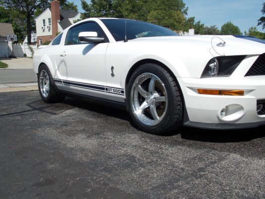

too tall IMHO, a 28" really filled up the well on the rear, take a look at the rears on mine, 255/45 work nicely on these cars on all 4 corners
a 29" with all that sidewall would hurt the handling as well I believe.
