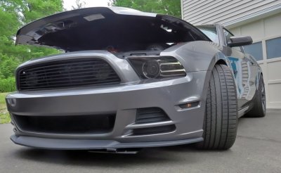

Yes, my car is lowered, on BMR springs, 1.5" lower in the back.
My wheels are the OEM 2010 GT500 convertible 18x9.5's, I think the offset is 42mm.
I've had 10"-wide rear wheels with 48mm offset and with 305's on them, it fit perfectly.
A 3mm-lesser offset would not have created a fitment issue.
My second current set of 18's are 18x10 with 45mm offset, the rear tires are 305/40/18, they fit perfectly:

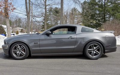

You're welcome, and thank you!
Yeah, fitment should be the same. Springs are the same.
A side shot:
