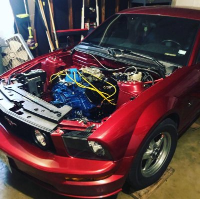

So i took the leap and decided to put a 460 in my s197 and ditch the 3v. My question is do any body have the wiring diagram for the instrument cluster i would like to try and make the stock gauges work with the big block. I have found the ones for the oil pressure sensor and the fuel level but thats it.

I am very interested in your swap.
Do you have a link to a build thread ?
Would love to see some pics on how far back the engine sits
