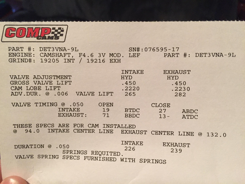

I think brenspeed still won't divulge the specs on the Detroit rockers (NA cam)

Good find lol never thought I would see it. LSA not there though?

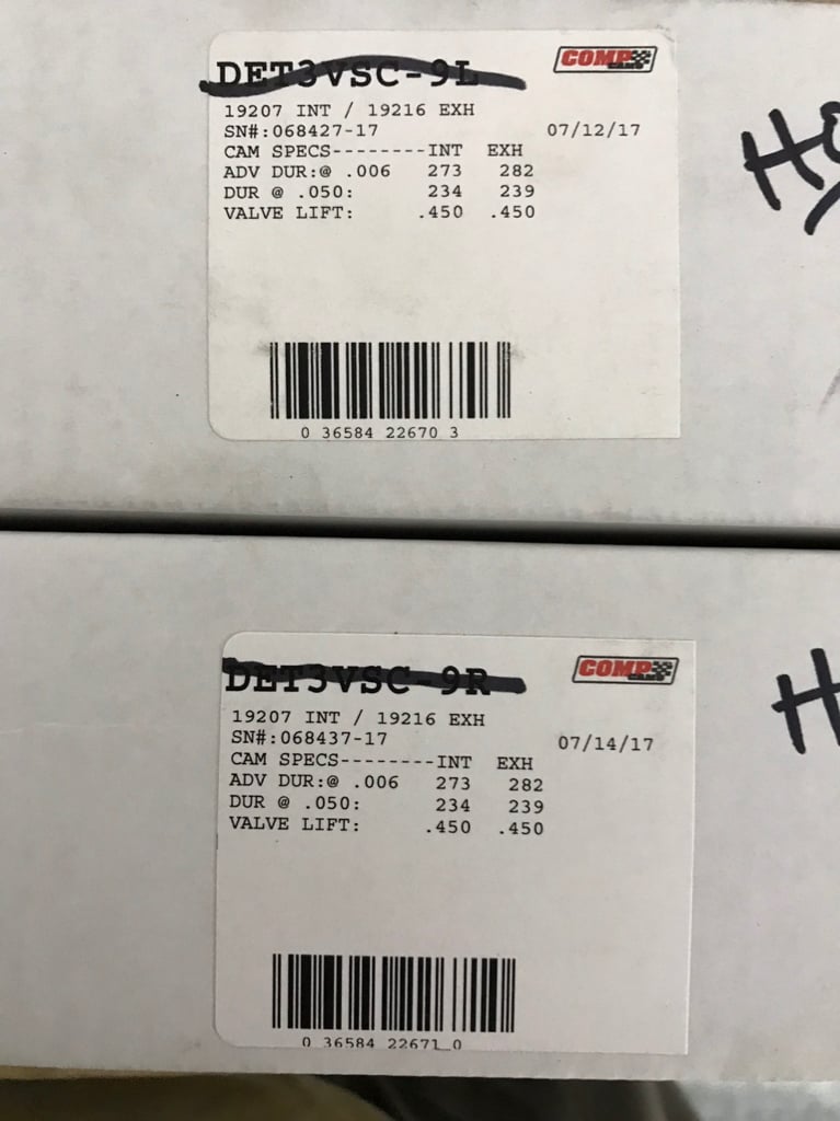

The LSA is midway between the ICA & ECA. For the Detroit Rockers (NA version) that's 113 degrees. The supercharger versions of the Detroit Rockers have 8 degrees more intake duration but the exhaust valve opening specs are the same as NA.
