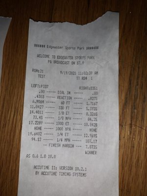

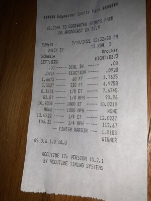

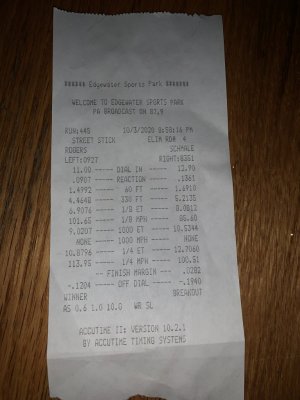

I’ve been having consistency issues with my car I’m running e85 and a lito tune, car is NA and pretty basic. Last year I could run high 12’s pretty consistently with a worse 60foot in the heat but now it’s all over the place. Last weekend it went 12.83 at 100 and I was off the gas at the end…then it proceeds to run 12.90’s to 13.00’s at around 106(same day) one pass was 107. Sometimes it’ll go from 82 in the 1/8 to 83,84, or 85. I’ve got a shift light so I know I’m shifting consistently. Lito is using a bullit tune file for my tune which uses knock sensors. Could the 2 step be making those go off? Any suggestions would be appreciated. Thanks. Time slip picture was posted from today.

Post multiple timeslips. Trap speed and ET will change with your 60 foot.

The passes you made on the same day look to be getting slower with every pass. Temp is going up. You're hot lapping the car. Tiny imperfections in your driving. Even with a shift light you're not going to be dead on every shift. Some of your 1000ft times are very close considering the variance in 60ft. But the final mph is falling off later in the day. Once again pointing to heat soak and/or high humidity. You're time slips are very much what I would expect.
