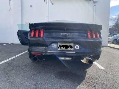

I’m posting a picture of the dealer’s diagnoses to gather more input from you guys along with a picture of my rear end collision that made my tailpipes uneven (perhaps the wobbling is caused by the asymmetrical thrust from the exhaust?)
Strangely enough, they test drove it and “found nothing wrong” so I insisted on taking a technician on a drive with me to illustrate the obvious wobbling effect that occurs during high RPM acceleration. Tech said the exhaust was a possibility, but that the wobbling might be occurring because the new motor needs to “open up” still. Does that even make any sense?C6AE7D9F-C712-4F8D-900E-67858B84841C.jpeg22F6F6F3-8E73-41B2-935B-C65B2903789D.jpeg

Aside from the visual, the exhaust would not cause that. But, maybe you want to get a bit more descriptive of this "wobble".
Is it wandering, vibrating, shaking, or is it something maybe the fly by wire throttle is doing?

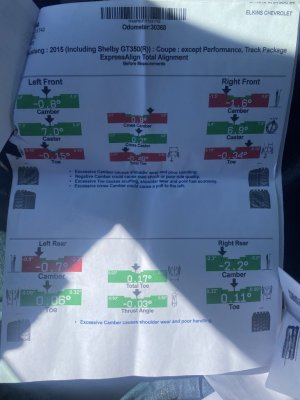

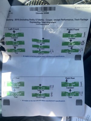

How bad was the rear of the car from the accident? Any pictures? Any picture of the final Alignment Specs?
I posted a picture of the accident further up in the thread. But here is the before and after alignment specs. Also, why does it say “except performance, track package” I have the performance pack 7CD365ED-E101-4B9A-903C-5664C06340F0.jpeg BADBC2BD-CB38-454C-8520-443B57FEEF7A.jpeg

They could have tried to move the Rear Camber a little more. Yes it's green, however ideal would be -1.5. Negative Camber indicate that wheel at the top is leaning further in than ideal.

Those alignment specs even before aligment do not support what you are describing.

On the alignment spec sheet it says “except performance, track package” but I actually have the performance pack suspension. Do you think that might play a role in this problem? Perhaps they aligned the car in accordance with the regular suspension GT?
I would need to see both specs side by side.
But in general, NO. Alignment issue would behave the same all the time. Camber mismatch from side to side would cause a pull. I seriously doubt you could feel anything from rear camber being out of spec. Unless its out bad, and yours was not that bad.
Toe out may feel like the car is wandering. That is why factory specs some toe-in.
Specs IMO are just guidelines. More negative camber will improve lateral grip, to a point.
