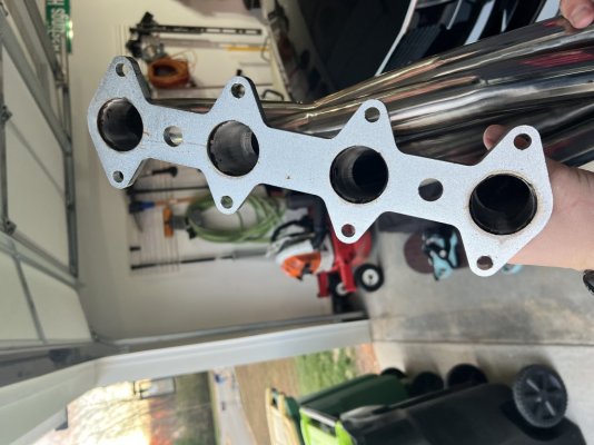

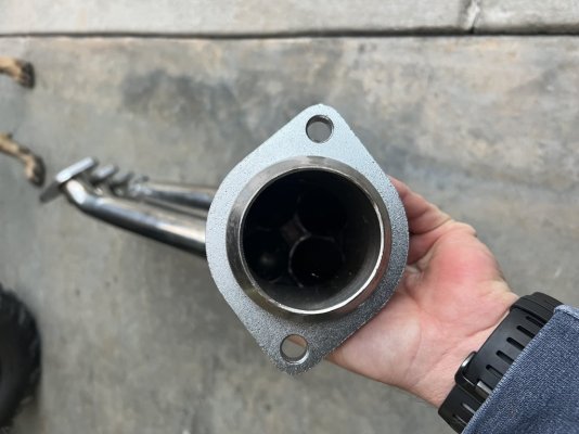

I am in need of some assistance in figuring out the next step on some exhaust issues I have currently.
Over the last little bit, I have collected parts as I have found them. Most recently a X-pipe from BBK and some headers with an unknown brand to me.
With this all said, the headers and X Pipe do not match up at the flange / collector. I have attached some pictures to describe what I’m referring to the best I can.
At this point, I’m assuming they won’t match up and work together so I’m looking for the best options at this point on what to do next. I am open to all help, suggestions, etc, that I can get.
Thank you!
EBABlacknChrome
Jan 15, 2017
1,105
629
Michigan
BBK does not fit anything but BBK. You could take mid pipe and headers to a custom exhaust shop and have them re-work the ball socket to fit the header as it looks like it was stretched out to begin with. Ebay headers?

I’m not sure if they are eBay headers or not. I can only assume they are. Would it be wise to move to a different brand of header or will these work okay?

They look polished, BBK and pypes are the only ones I know of that way. . Are they even for a 05-10 3v? They look similar to the 03-04 5.4 LTH. If they were cheap and you can make them work then have an exhaust shop reshape. Or by the BBK LTH

I believe they are. Bought them from another person who said he got them for his 4.6, 2 Valve, and then realized they were actually for the 3 Valve car. They are super accurate to the looks of the BBK

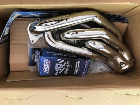

If they were BBK or any reputable company (kooks, etc.) wouldn’t they be stamped with manufacture and part numbers?

It would be tagged just like pictures I posted. My guess is ebay knock offs of BBK

Yes, all other major brands have some sort of tag spot welded or attached somewhere on their products.
Yup.
I think at this point, I’m gonna reach out to a local custom exhaust shop and see what they can do or if they can even make this work. What are the odds a shop is able to salvage this?
