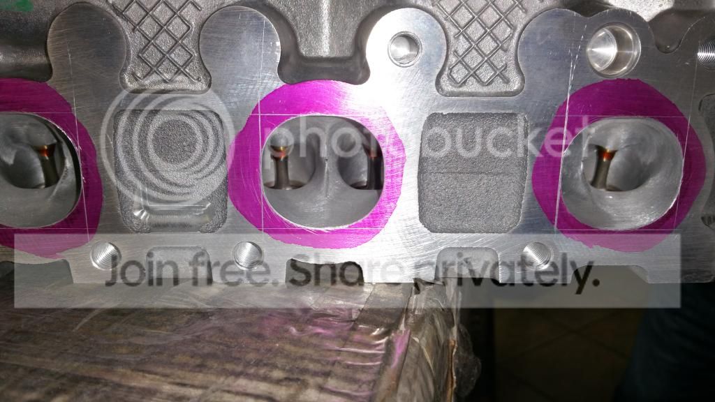

Ported factory heads

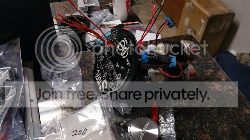

Fuel System:
Fuel lines
Fuel Filter
Fore Fuel Pressure Regulator
CPE Triple Hat
3 Walbro 485's
Fuel Rails
Wiring Kit
All fittings etc.
ID2000 Injectors

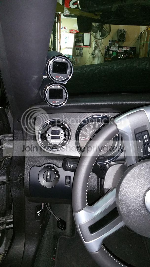

Gauges:
E Boost 2
Aeroforce Dual Guage Setup
Roush Gauge Pod
Speed of Sound Dual Gauge Pillar

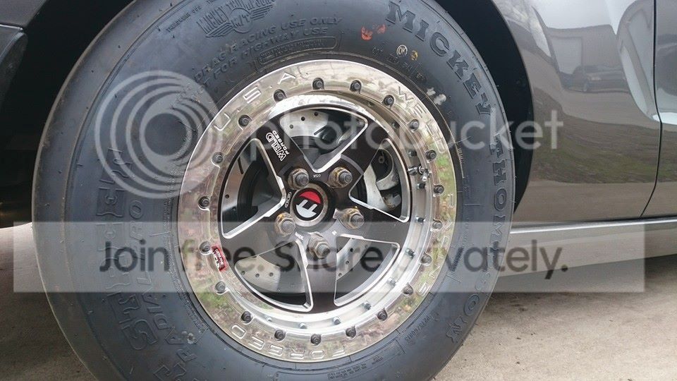

Wheels/Tires:
SVE Drift II 19x9 in the front and 19x10 in the back(FOR SALE).
Nitto NT05's 275 fronts 305's rear
Weld RTS wheels with Bead Locks
Mickey Thompson ET PRO Drag Radial

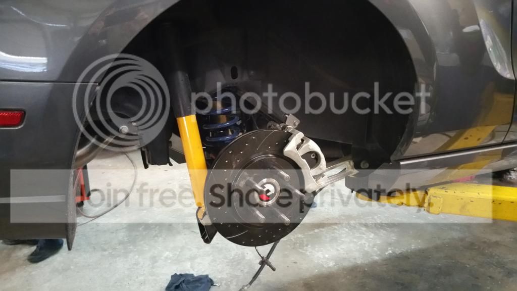

I called my buddies, mainly Mike Cotter, at LRS(I grew up and raced with most of the employes there as I lived in waco over 20 years) and placed an order for the wheels/tires/suspension components the day I bought the car. They had the catback, and grill accessories in stock so I figured why not.

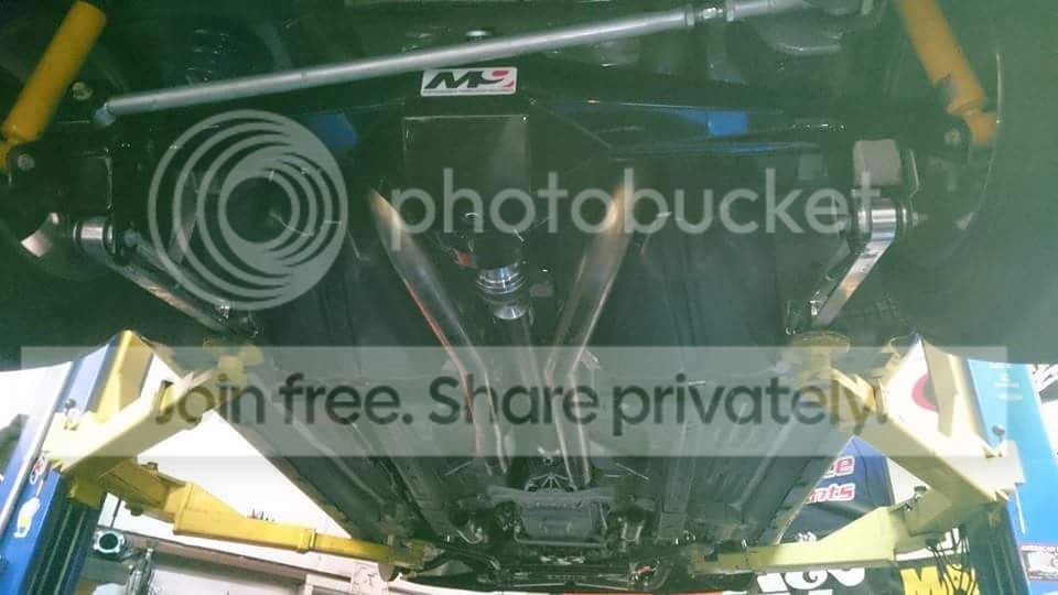

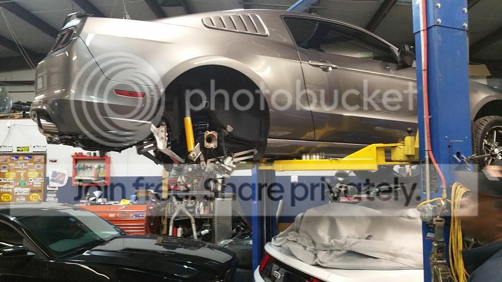

Went up to Waco the weekend after my father passed to pick up the parts. Mike Cotter, another friend, and I went to work lowering the car and putting the suspension on. Came out with this...

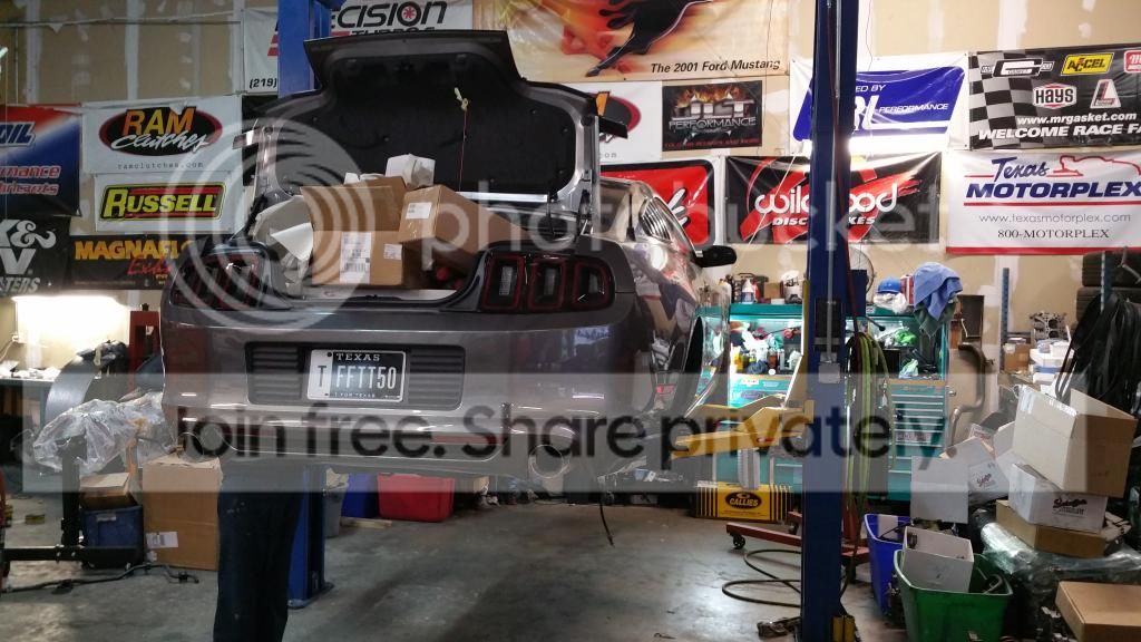

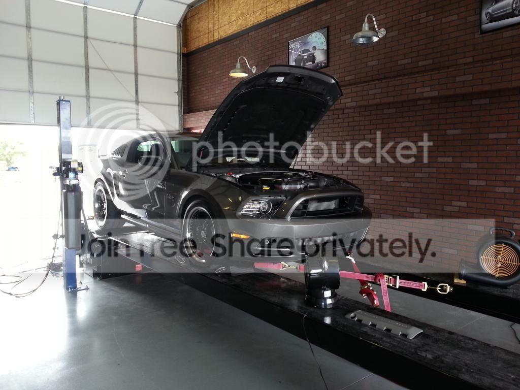

Went to LRS. Jmac wanted to place my car on the dyno to get a base line and to load a SVE tune on the car. I don't remember the numbers but it picked up a good amount, and the transmission shifting was awesome. Just sad I only put about 60 miles on the tune before I put the car on the lift Friday night and started tearing it apart.
Got a lot done to the car, but caught my wife's cold and it put me out of commission by the evening.
Hope to "finish" the car next weekend. Then towing it up to HPP.

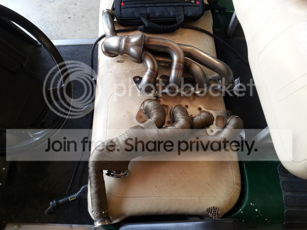

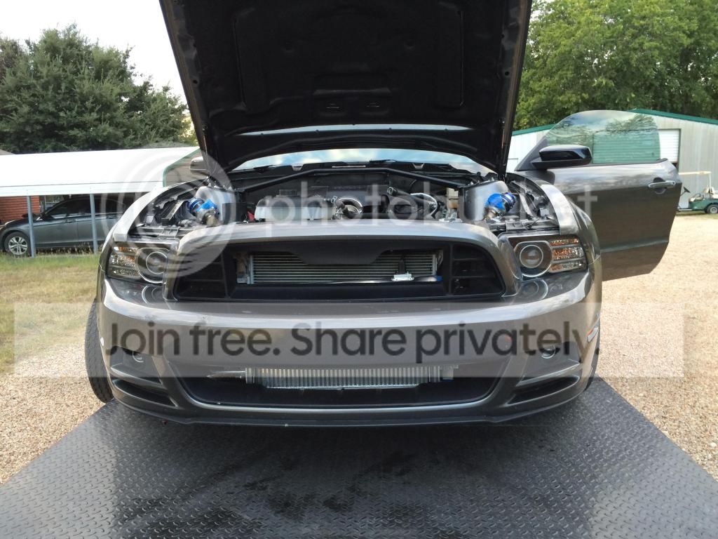

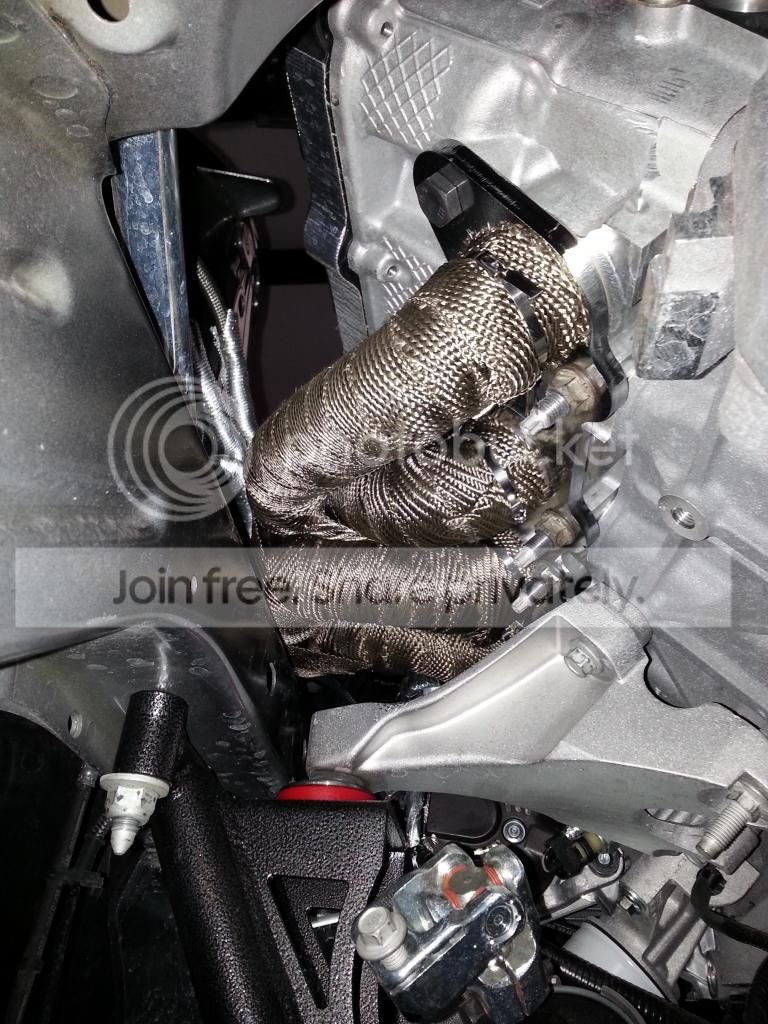

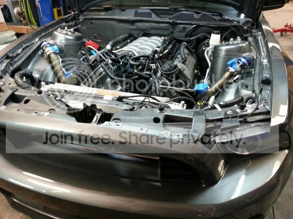

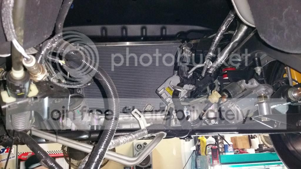

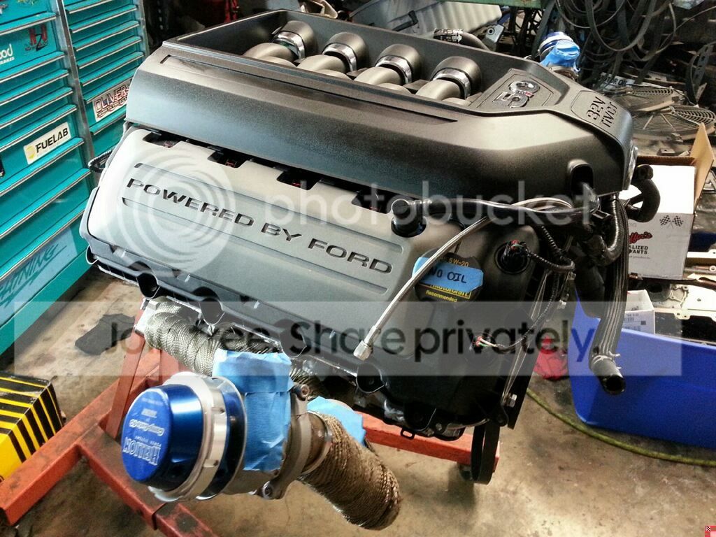

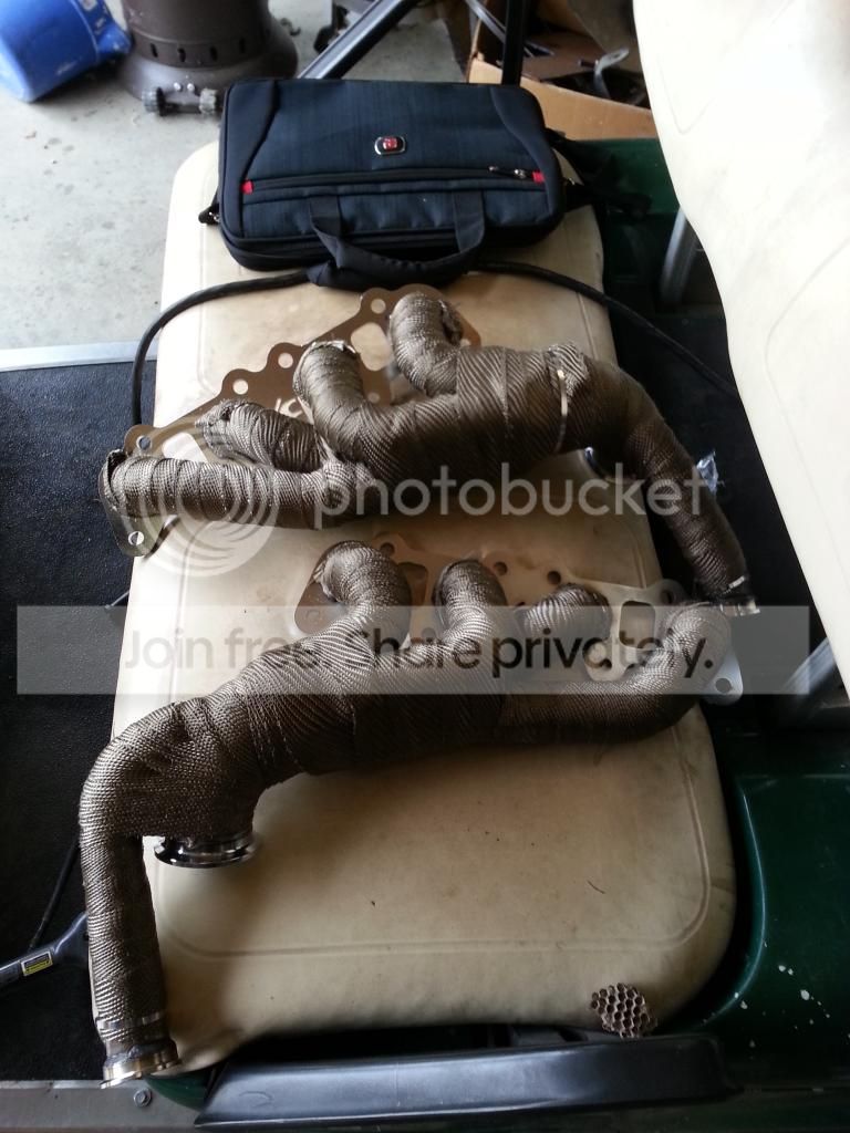

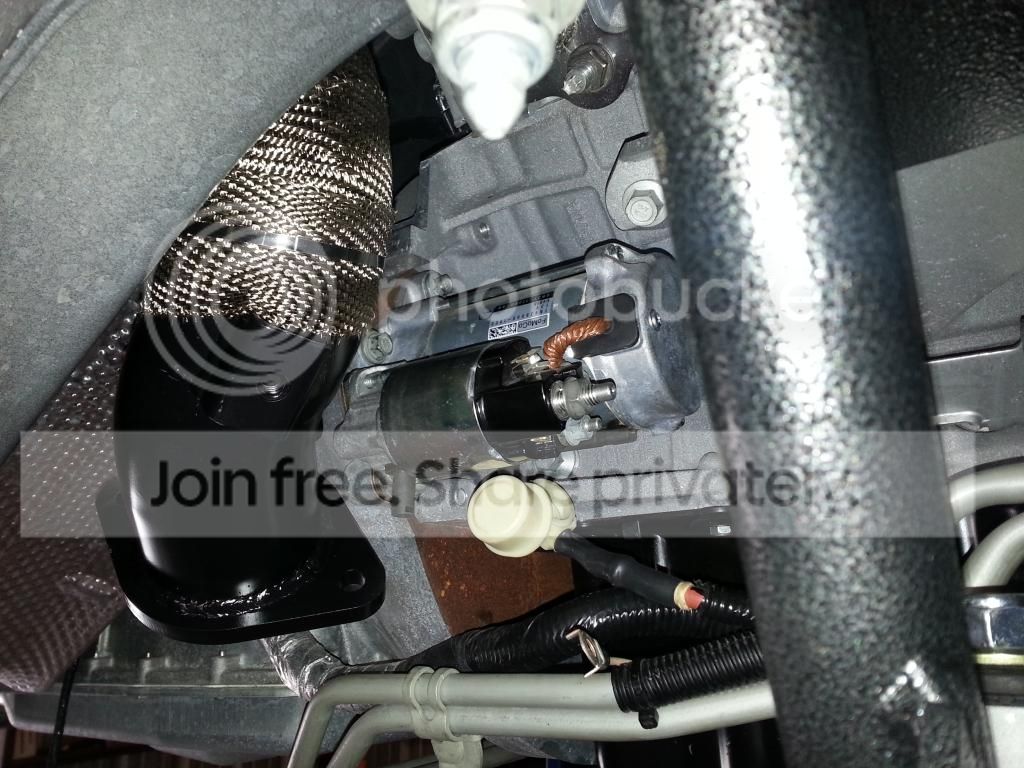

So got 90% of the turbo system installed. Then took it mostly back apart and dropped the car off at HPP.

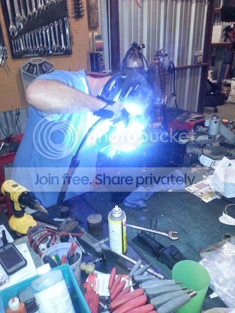

Welded up the oil drain fittings into the pan, and wrapped the headers(my first time ever to wrap).
Also..buy an aftermarket k-member, you can get the top starter bolt back in.
Nothing in this kit is made for someone with large hands.

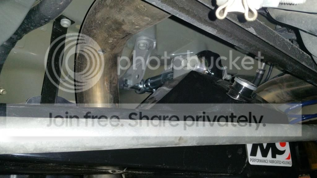

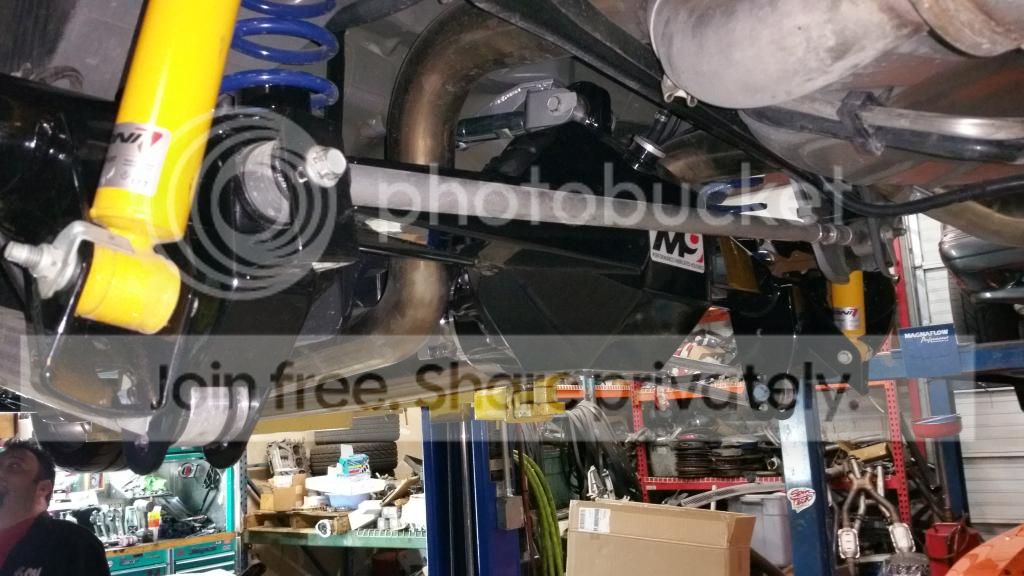

My fabricated 9"
And that inter cooler sure does look mean.

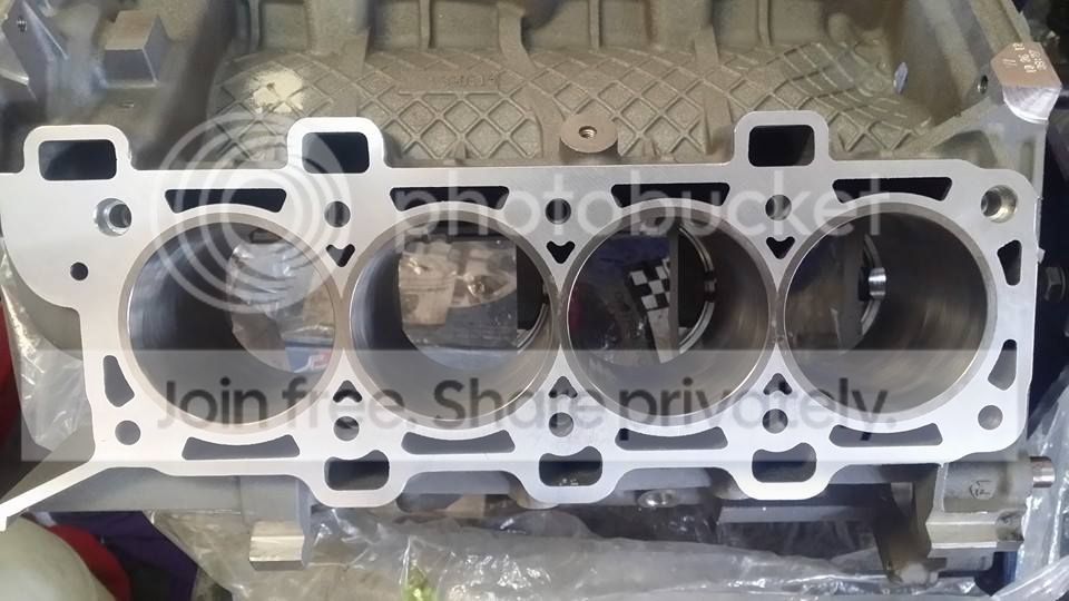

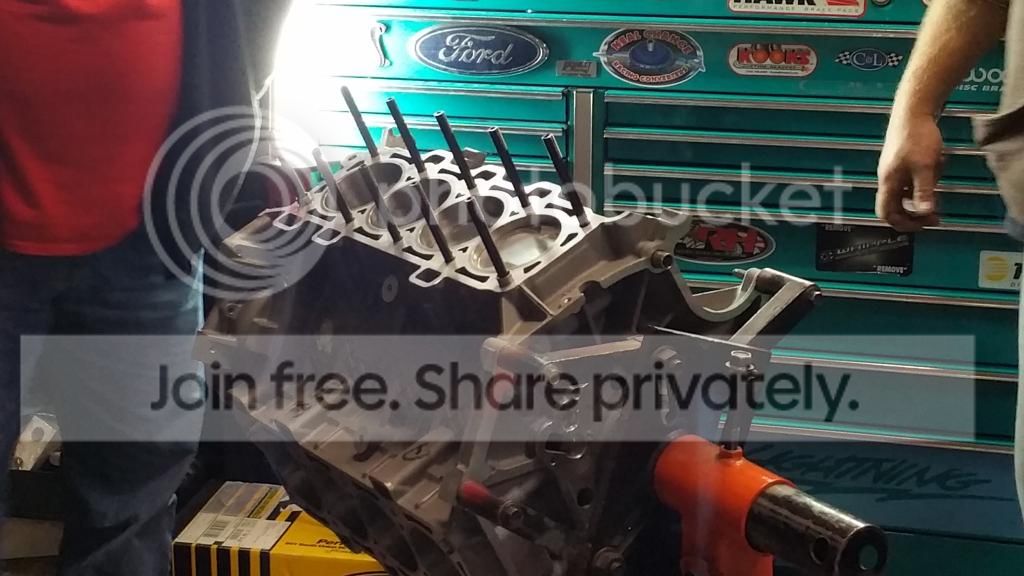

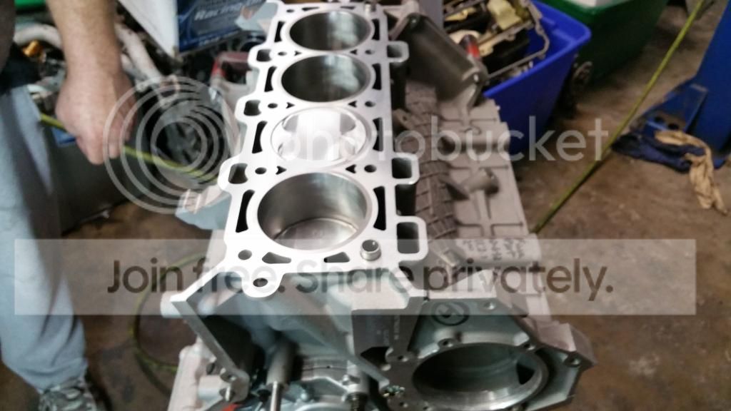

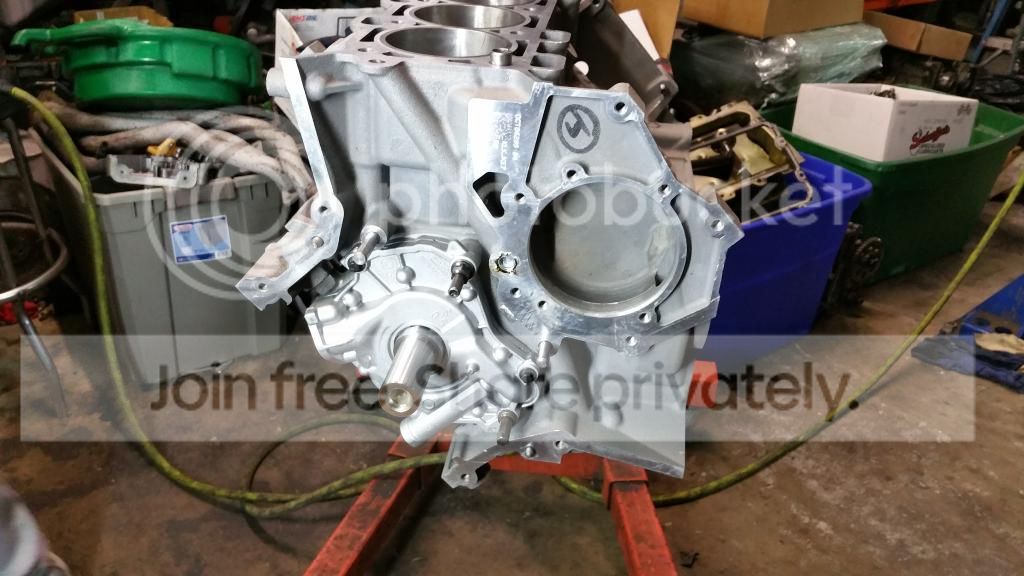

Block is in!
FATHERFORD
Apr 28, 2011
43

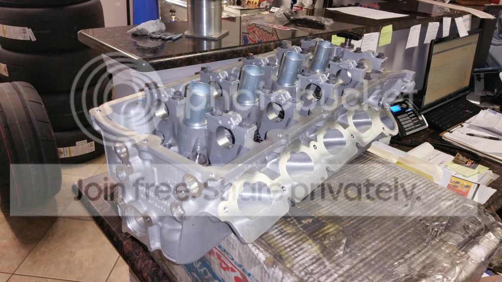

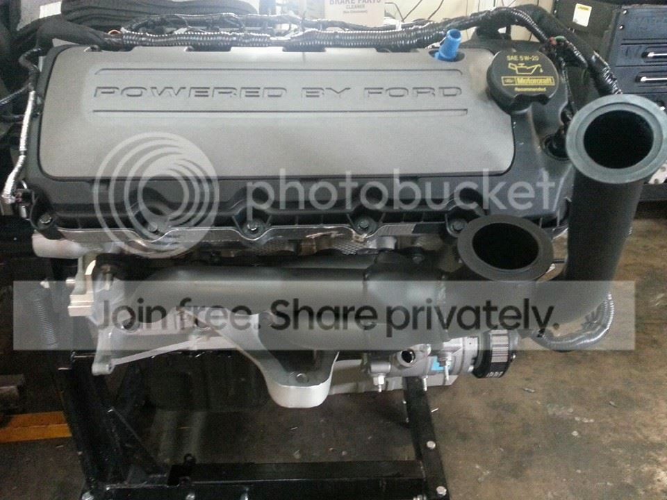

Where is the engine?

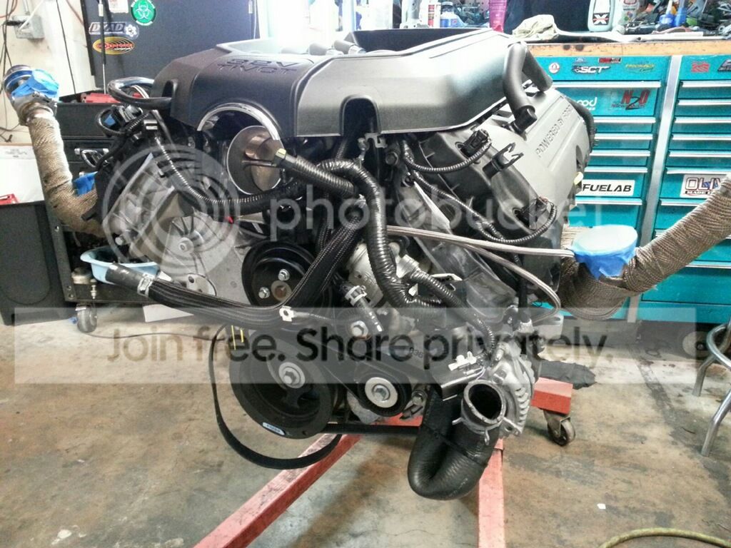

Here she is

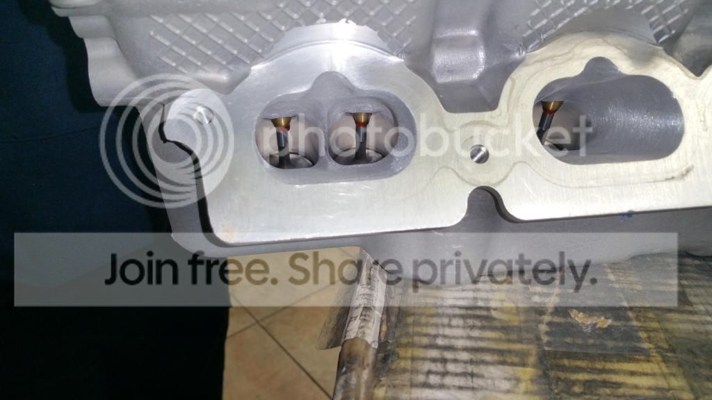

Look closely.... my late 14 had 15 parts....even the heads!
Should be getting more pics today with the engine built. Then Monday engine and trans are going in the car.

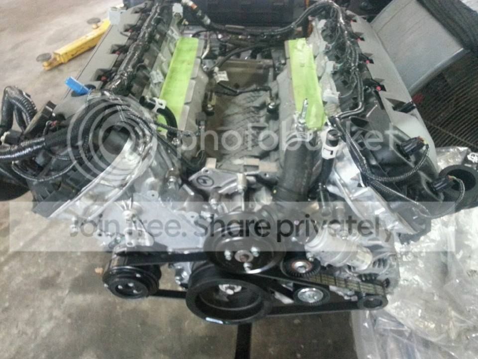

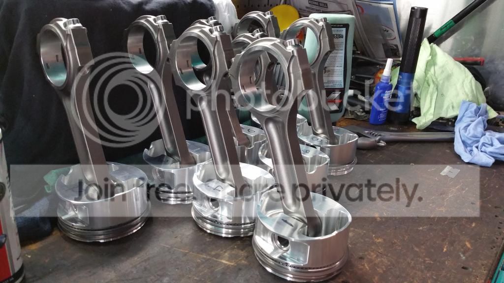

Finally got the motor apart and found a bad oliver rod. It was not machined correctly and the bushing walked... Oliver instantly owned up to it and is sending a whole new set of rods.

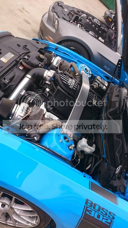

Still waiting on the rods...Went and checked my 2015 build, took a few more pics. Posting cause of boredum.
Motor is back together, and went ahead and coated the rest of the kit.

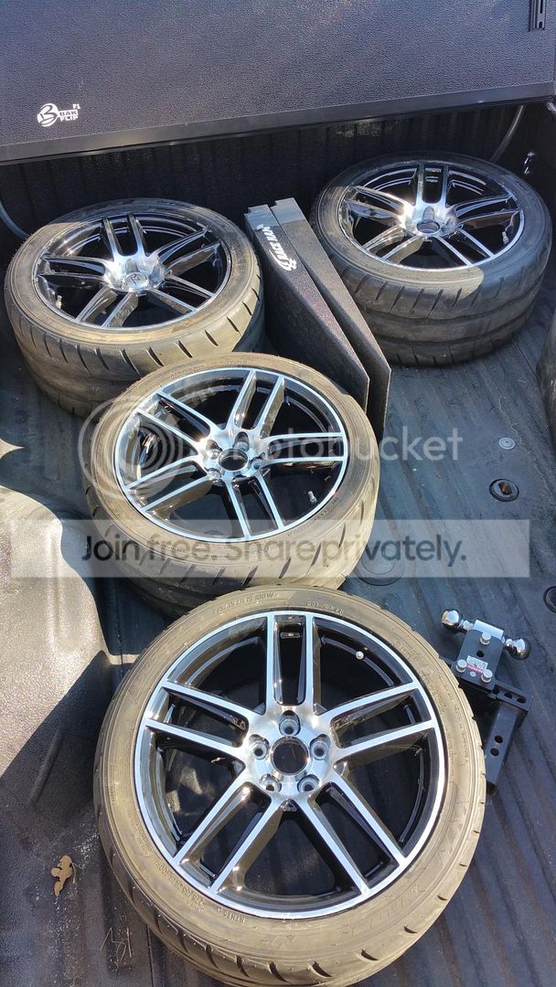

had to get some different wheels for "street" tires. I couldn't drill out the drift II's for the 9" rear.

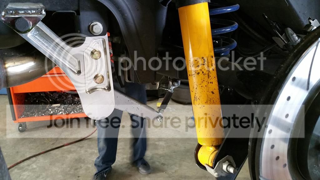

Got the steeda anti roll bar installed.
Started tuning on it last friday, but ran into some difficulties. After the problem was discovered it was really to late. I'm crossing my fingers next friday.

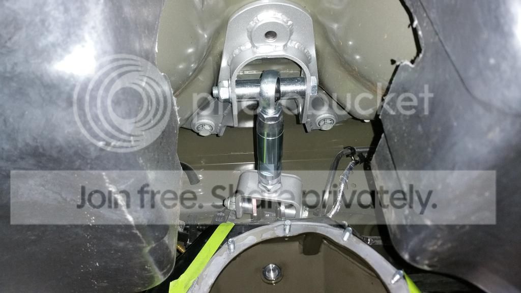

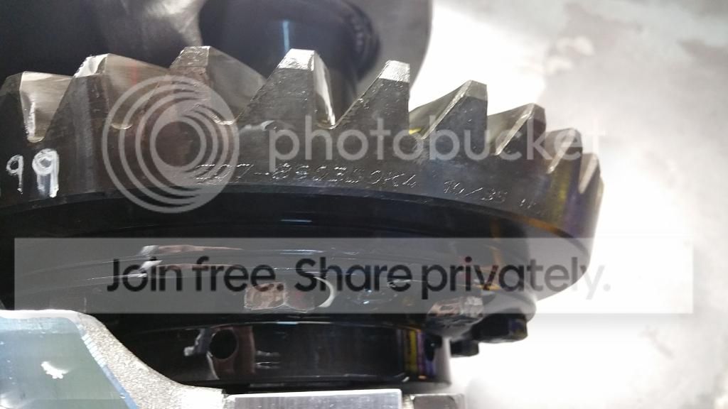

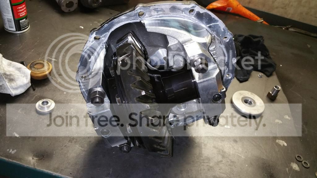

So moser is full of fail. Manny(the tuner) started driving the car, and noticed the rear end seemed a little louder then it should, friday I was riding with him as we were trying to get all the driveability part of the tuning ironed out and the rear started making horrible whining noise and sounded like marbles... WTF..
Called Moser, they said that isn't right, pull the center section and send it in...
What we discovered...
The gears where not set up right.
Biggest thing.... The F'n wavetrac I ordered was not in the center section, it was a locker!
So Moser sent the wrong length axles, the wrong abs rings, the wrong diff, and set up the gears wrong... I'm thinking the guy that put together my order got his two week notice like the guy that built my Oliver rods.

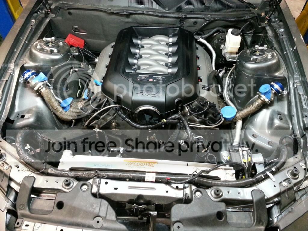

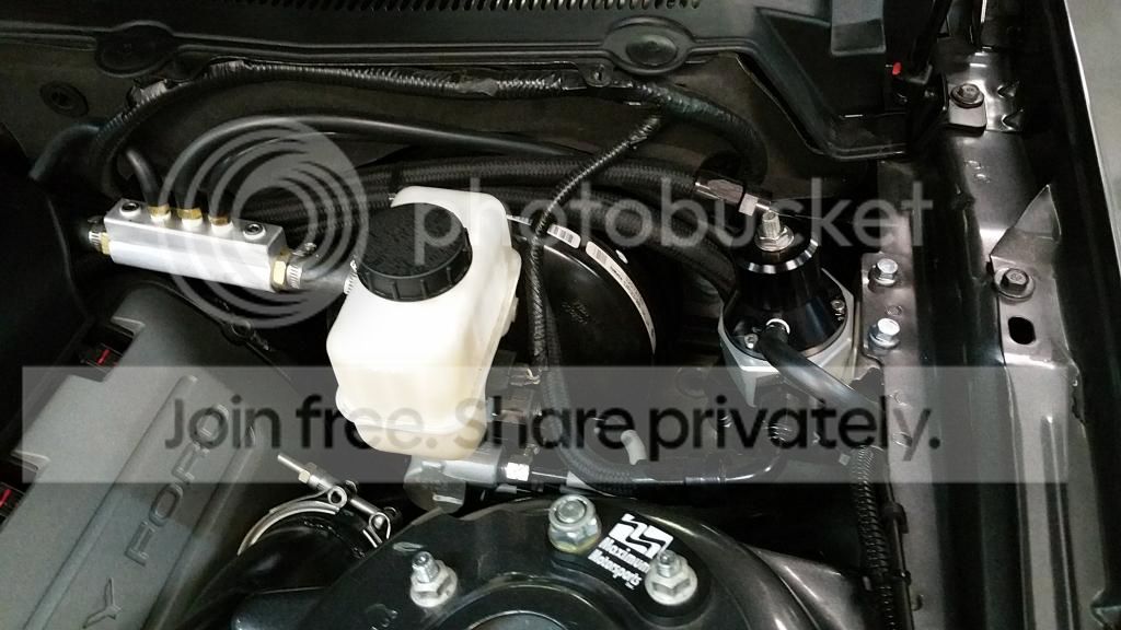

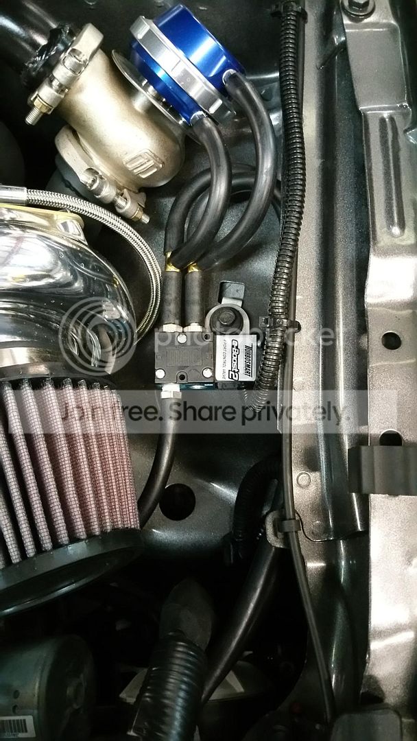

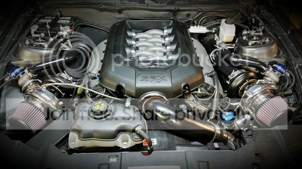

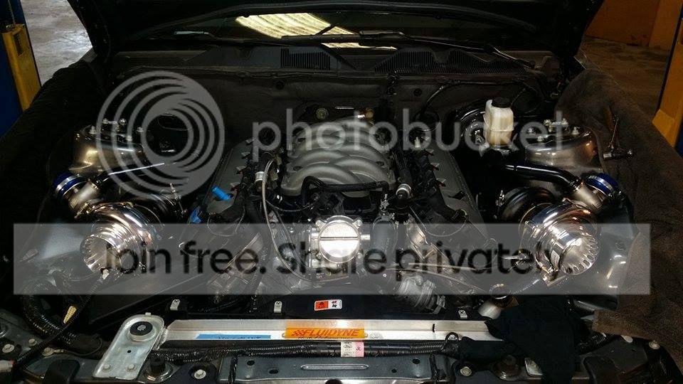

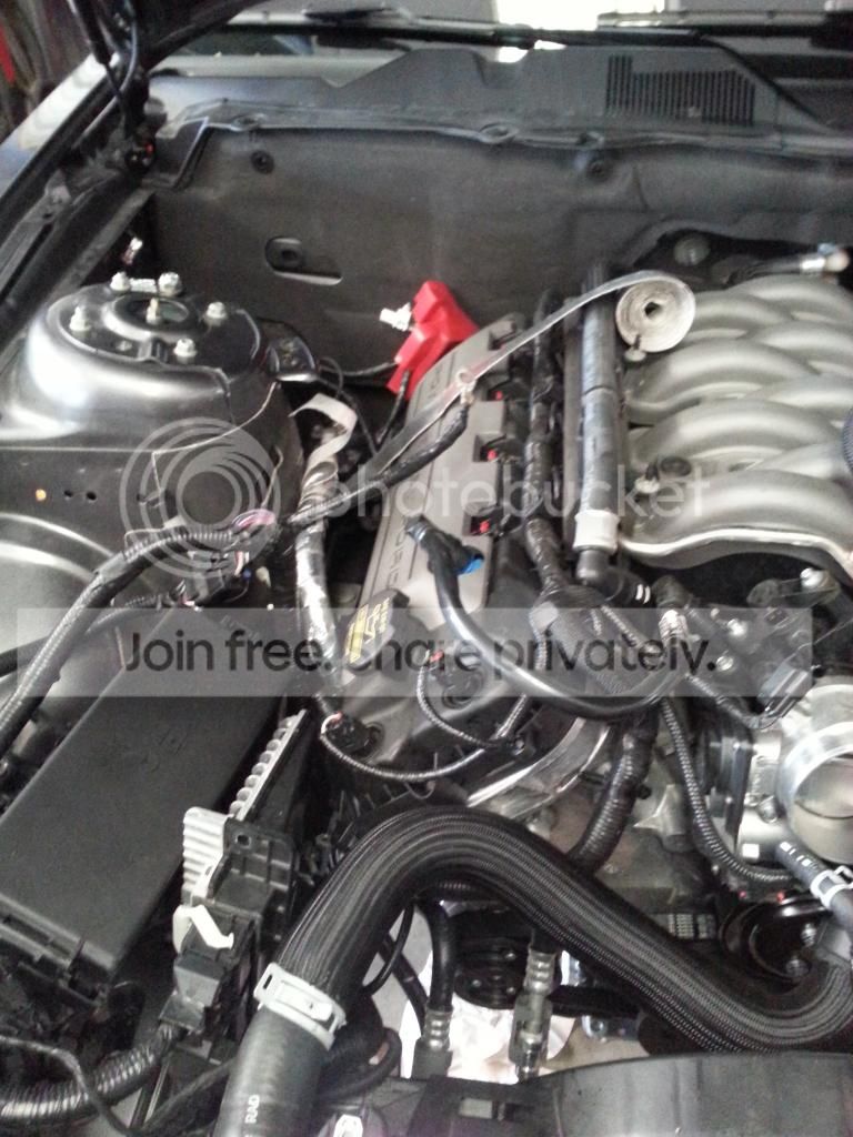

close up shots of the engine bay...

Not nearly done tuning yet, but here are preliminary results from last night. More tuning, and will probably take the advice from hellion and bump to 30psi.
8psi = 600rw
12psi = 750rw
16psi = 980rw
21psi = 1040rw
26psi = 1140rw
