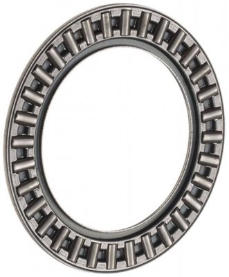

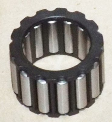

FYI - The 1st bearing to go out on the TR3650 is the input shaft. The second is the pocket bearing and needle bearing between input and output shaft. This is a stock pocket bearing with bearing cage made out of plastic (thank you Ford and Tremec) and a needle bearing that sits between the input and ouput shaft. Neither are very beefy.
