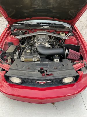

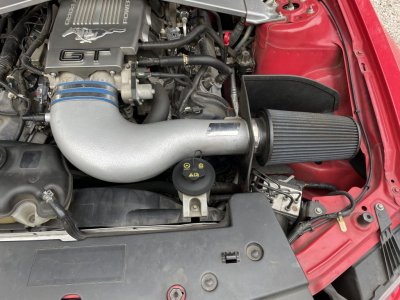

Got the JLT intake & tuner yesterday so I installed it this afternoon. I got it from BAMA so I only have their 87 performance & 93 race tune at the moment. I’ve been running 87 so I loaded that up & took a spin. Seem to pull a little harder as the revs climb but it isn’t night & day. I’ll fill her up with 93 & load the other time to see if I can tell a difference. Car could have already been tuned as it had a BBK intake already but the previous owner bought it that way. It’s still shifting better by a ton but not where I want it to be. Next step will be to vacuum bleed the clutch. Would motor mounts be the next step?77EA1214-F996-4FC1-9BE5-185D3E5A0214.jpeg49227BC7-71B8-459F-88E6-513BF23B9AC8.jpeg

I'm sure solid mounts will help. They also make some arms that you can buy that brace the tranny. I forgot what they're called or who makes them because I drive an auto but I heard they work pretty good at keeping the tranny from shifting which helped smooth out some people's issues.

Torque limiters. Can’t seem to find them now. I guess they quit making them. Also loaded up the 93 tune. Can definitely tell a difference with that one. Also got in touch with Lito, going to have him do me a tune.
