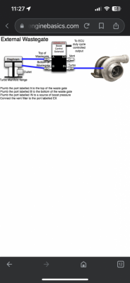

The article you got that image of how to plumb a 4-port BCS from answers a lot of this but I'll clarify a few things that may help you out.
1) The wastgate is located between the outlet of your exhaust manifold (after the merge on your V8 if using a single turbo) and the inlet of the hot side of the turbo. It's job is to allow some of the exhaust gasses to bypass the turbo to control boost pressure. It can be piped either straight to atmosphere or back into the exhaust system downstream of the turbo.
2) Boost creep happens when the wastegate is not large enough causing too much of the exhaust gasses to be pushed through the turbo. I have no idea what the YouTube video you referenced is talking about. If you're getting boost creep, you need a bigger wastegate.
3) A 4 port BCS can not be used with a single port wastegate actuator. At the boost levels you're looking to run (16psi) it isn't necessary either IMHO.
4) you won't be able to keep boost at zero in first gear. There is a spring in the wastegate that sets the minimum pressure the wastegate will open at. The BCS can only add to that minimum.
yessir…clarity is what I seek lol
1. I did a lot more looking so I understand better about what your saying about the pipe merging & how it works to bypass
2. On3 told me with the levels I’m wanting to run I’d need the bigger gate. They didn’t think the 44(?)mm they offered would do me good either so I did the upgrade. Hopefully I can install the kit per the instructions and the bigger gate will eliminate creep.
3. I believe the wastegate I have offers dual ports. My want for the 4 port was mainly concentrated around lower boost control but I see what you’re saying.
4. That makes sense bcz my wastegate came pre assembled with a 3lb inner, 7lb middle, 14lb outer spring so 3lbs would be the lowest I could run. Makes sense

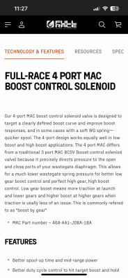

This quote in the article above is what I thought I needed a 4 port but a 3 port will do the same thing?
“This allows for a much lower wastegate spring pressure for better low gear boost control and perfect high gear, high boost control. Low gear boost means more traction at launch and lower gears and higher boost at higher gears when traction is usally less of an issue. This is commonly refered to as "boost by gear"”
