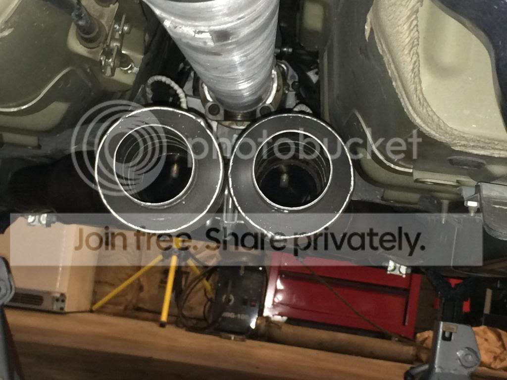

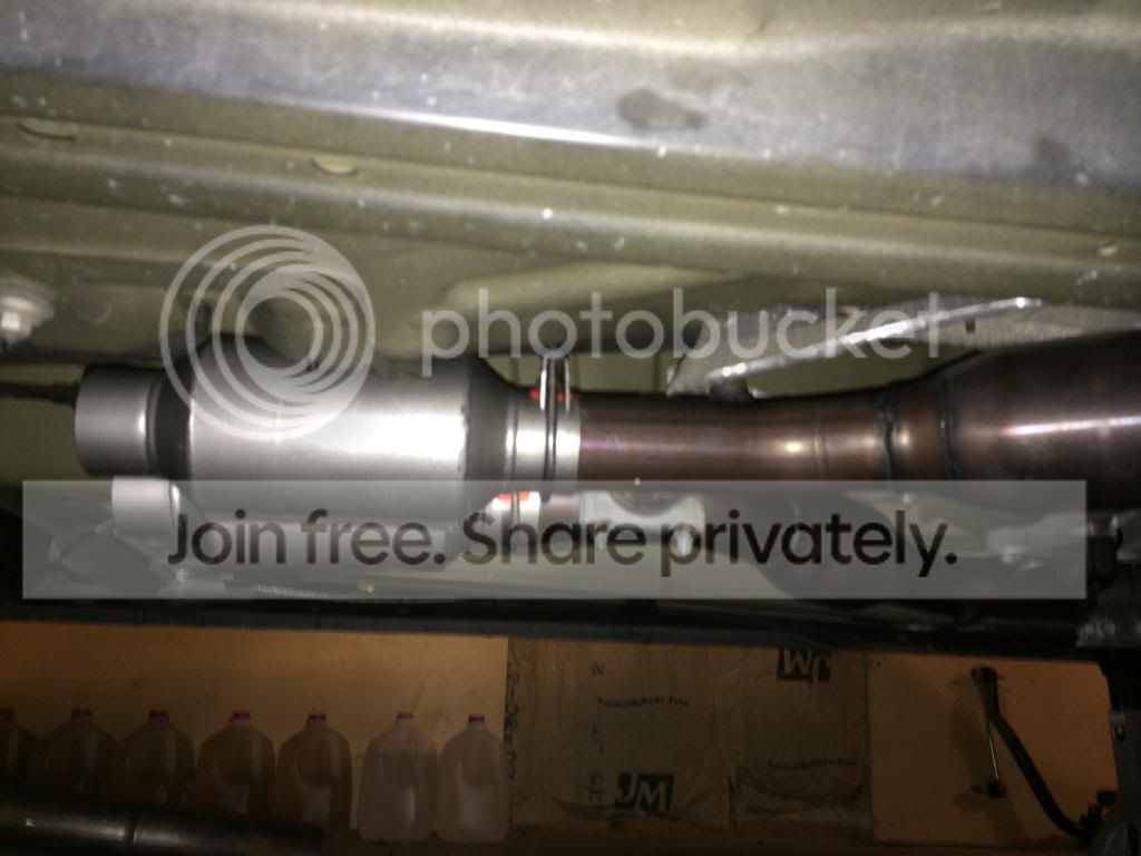

Here are a few pics of my exhaust. They are flowmaster outlaw mufflers 7" long. Got both at summit for 209. Had to have the inlet opened up a little to get them over the hpipe. They sound great outside the car but it's pretty loud inside.

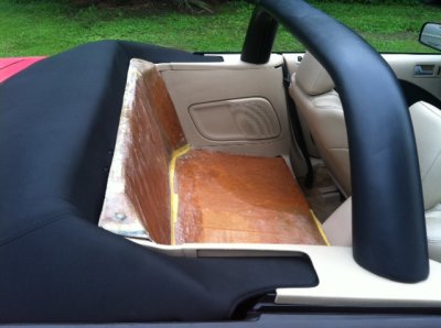

FX1 Seats ordered!
Custom rear seat delete made. Weighs in at 3lb so far. going to cover it with leather.
What's with the clamp in the center of your h-pipe? I've considered a similar exhaust setup for track days, any chance you can post sound clip vids?
