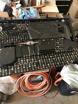

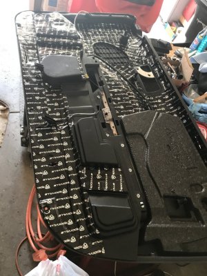

Here's a few pics of the driver's side door panel for reference.
