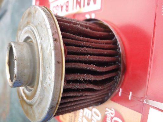

So the answer appears to be pure coincidence. The attached pic is my Amsoil filter with the special metal flake.
MrBhp
Sep 12, 2013
1,266
1,050
That's not good. I don't think so anyway. If your timing chain tensioners experienced catastrophic failure I think the chain can contact a piece of the cover.
