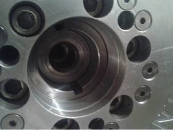

The IW is very thick and does not sit flush with the end of the crank snout. I'd say about the crank snout is about 1/4"-3/8" recessed inside the hub. Mine came with a longer bolt.

^^^ Mines looks exactly the same

Yea I even emailed IW cause I wasn't sure and they confirmed this is how their's sits on our cars.
