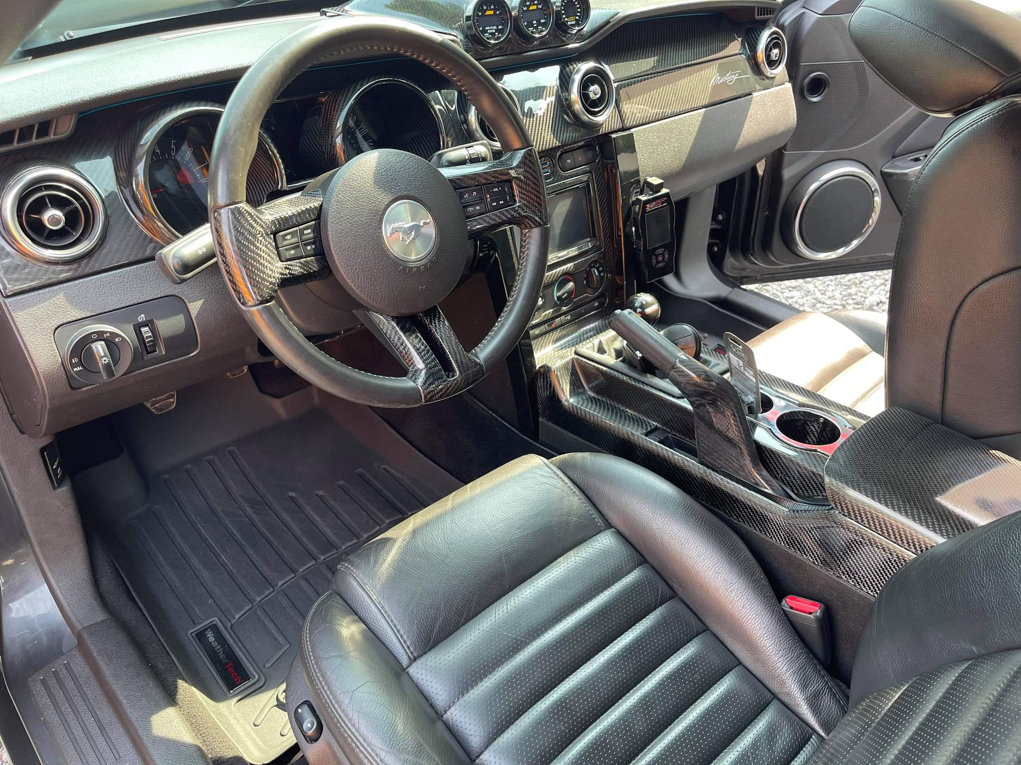

Hey yall. I've had a lot of people interested in my build. This is mostly just going to be eye candy.

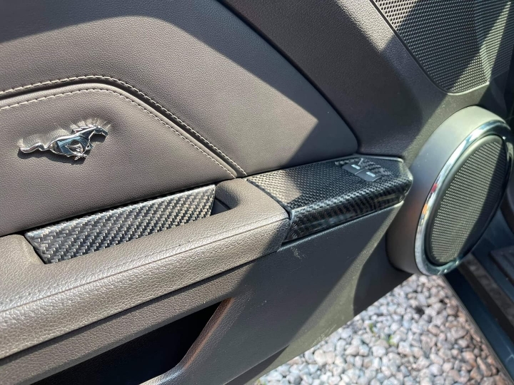

All carbon fiber interior is real, no overlays or stickers, some pieces custom made by me.

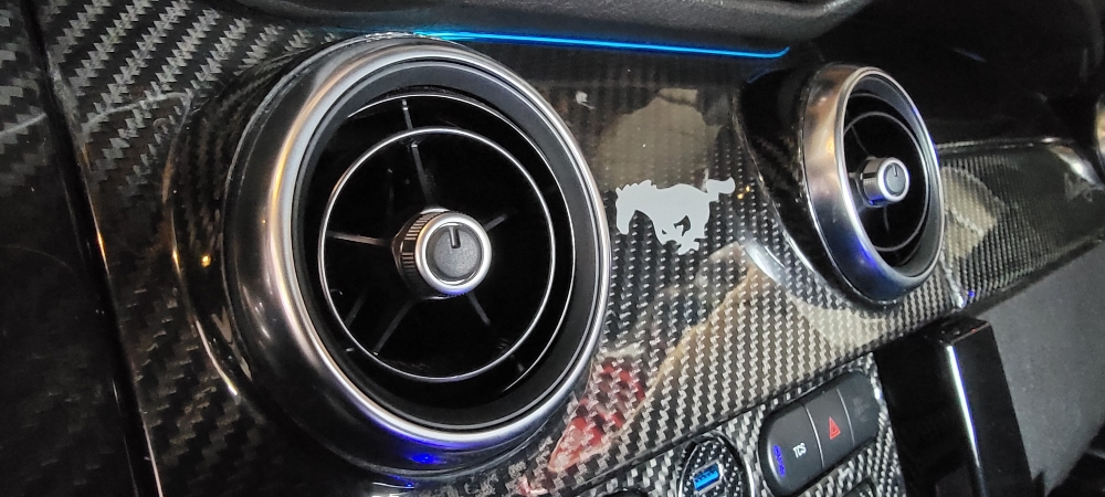

Air vents are out of a 2016 mx5. Slight modification required.

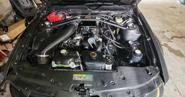

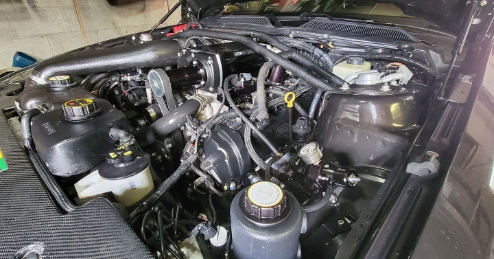

Forged engine, parts all from Joey Teats at Apocalypse performance
-Manley forged 8 bolt crank
-Molnar rods
-Upgraded pins
-JE pistons 9.5:1 compression
-Bored 10 over
-Boundary oil pump
-Kennebell intercooled supercharger at 20psi
-T56 magnum xl and one piece driveshaft with billet yokes
-Mcleod rxt clutch
-Custom grind cams from Todd Warren (everyone boosted should get these)
-Fore l2 return fuel system with fc3 controller and hobbs switch and fore vacuum/boost manifold
-FIC1000 Injectors
-Ford performance twin 62mm throttle body
-BBK longtube headers
-Jlt catch can
-Steel braided clutch line
-Front Brembo brakes
Bmr suspension
Gt500 front/rear end facias
There's a bunch I'm not listing here but enjoy.

That is a lot off "not eye candy". lol I mean you cant see pistons, rods, cams, etc.
Just sayin'
teeje
Mar 7, 2017
563
102
Ohio
Just sayin'
Lol yea you're right. I wish I took pics of them. I have pics of the clutch engine and trans though. Missed opportunity:(

Curious on how you did your carbon airbag cover? Did you separate trim pieces, finish then glue back on?
