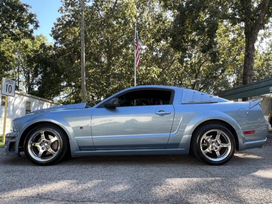

Just bought my first mustang, it’s a 2005 Roush stage 1 super charged 4.6l 5 speed manual.
