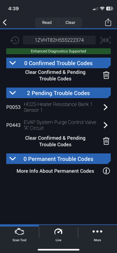

Update: unsure of what adjustments were made on stock tune I went ahead and reinstalled the 91 Bren tune and did a drive cycle. Couple concerns I noticed. 1) Evap triggered a pending code, then went ready shortly after. 2) O2’s went ready, then triggers a pending code. Catalyst still not ready though, but currently have 2 pending codes that I know will soon go active and I’ll be back to square 1.

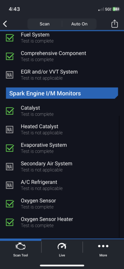

Changing the part took no more than 15min. Did a quick KAM reset. Next I did idle relearn. Followed by a drive cycle. All emissions test went ready within 15 miles of driving! Boom! Hope this helps others experiencing the same issue with codes: P0443, P0053, P0054, P0059, P0060.BA1CC049-AD41-41B8-9D77-FF54815B2282.png
