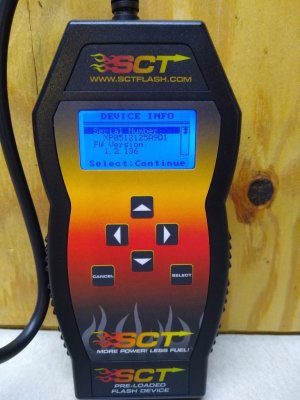

Hey guys, I inherited an unmarried SCT 3015 tuner with pre-loaded tunes on it. Through some research, I've determined that SCT no longer supports this device, which is all fine. Can anyone that has one tell me what firmware level they are at? My device is 1.2.147. I'm just curious how updated this old thing might be?

Just did a quick online search 1.2.136 is the most recent one I found. It looks like yours is a higher number.
