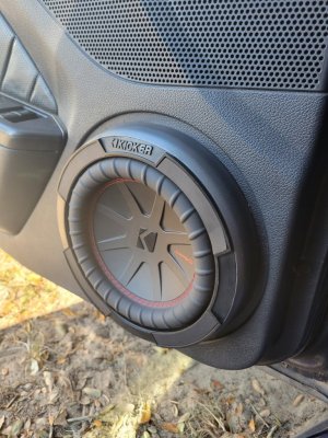

Finished my install last weekend and I am thoroughly impressed. This is another one of those things I wish I would of done a long long time ago. I was pleased with the Shaker 500 system, but this takes it to a whole new level, it's just amazing.
The equipment I ended up installing was:
Kenwood KAC-7204 Amp - Rated at 500W @ 4ohm bridged
2x Kicker Comp R 4 ohm DVC
2x Rockford Fosgate P1683 6x9 3 ways for the doors (I left the rear deck OEM for now)
I remolded the sub pockets to fit the Comp R's and only have to use a 1/4" spacer. I used the OEM wires, so the subs still plug into the door like they always have.
I coated the entire back of the sub box with dynamat. Also finished installing dynamat in the trunk, from the back sheet metal to behind the rear of the front seats is covered.
I'm working on modifying the OEM trim ring to go around them and make it look finished again.
It sounds so much better than the OEM setup. The sound is so full and energetic now, I can't really describe it other than I am extremely pleased.

Those door subs look so good like that. If it were my project? I might have gotten a kicker grill and clean up the spacer to make it look closer to stock. As much as I prefer the door speaker grills? Would look nice with those subs exposed.
Nice work.

Kicker grilles fo6t these look like a 6 legged spider, I don't like em.
I'm searching for a grill that I like, but I might leave them open for now and incorporate just the OEM trim ring for now.
Spacer is cleaner up and matches the profile of the speaker (the OD was way too big) and there's those notches I can't get rid of. I tried filling it in with black rtv, but each layer is a different color and stands out.
Hopefully the trim ring fixes that
