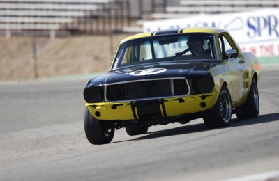

I have Vintage raced a '67 Terlingua Racing Team for many years. Y'all steer a live axle Mustang with the throttle, I don't hear the engine tone change as you hang the ass out & then roll into the throttle off the exit & then punch it & then shift. The engine sounds like it is bogging in some corners I revved up on a straight as Ya'll enter the corner. What rear gear are Y'all running & 5 or 6 speed ? I run a 3:89 with a 4 speed. I know they are very different cars but still Y'all seem timid on braking. Y'all gotta stop to set the car to slightly turn the wheel & then throttle through the corner ta steer & roll in the throttle as you exit to smoothly put the power down. willow springs 10.04 006.jpg
