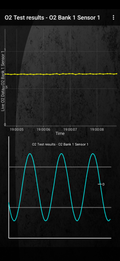

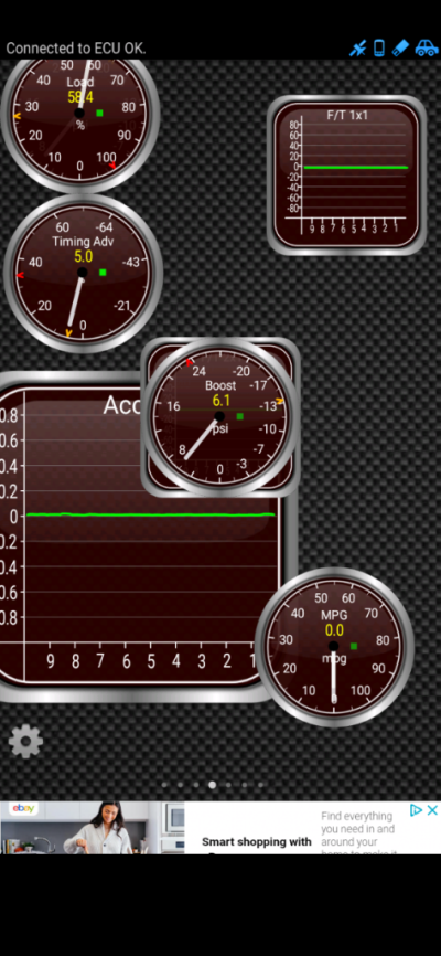

The car has 103k miles I believe they are the original cops. I did a kam reset but the issue of running rich persists. I have attached some more photos that may help.

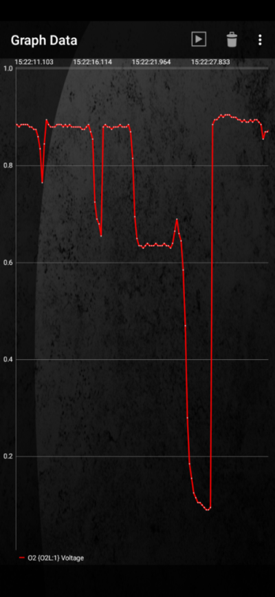

The below is an example of what the O2 sensors show on engine decel. I should note I believe the car is going very rich at idle and not as much when on the highway for example.

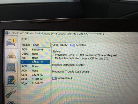

try forscan.org it ford software its got better dign capability, it will narrow down what wrong with your car, https://forscan.org/download.html <== that link
the pic is telling me my ecu is smoked and yes it was it would throw code for part i know worked, new-used programmed ecu cars run nice
