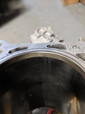

It really is a good idea to come up with a bore scope and look inside each cylinder for chunks. I have an inexpensive one I purchased through Summit. Great for piece of mind. Also, when you get the fuel line depressurized and disconnected it would be a great time to replace the fuel filter.

Go rent a bore scope or visit Harbor Freight. Think they're less than $100?
Mine is the $84. Works great.
Also, while you are working in that area. Clean off the rust from the negative ground bolt that’s on the strut tower.

Agree with the borescope. I would not even rotate the engine a mm until you know all the porcelain is out of there. If a piece of porcelain gets between the edge of the piston and the wall, it will dig right in.
This is when pieces of the #8 spark plug migrated to the #4 cylinder on my car after melting a piston. I was able to pick one of the pieces of porcelain out of the cylinder wall.

Went and bought a scope. We are still trying to get pieces out. This is almost ridiculous now. But hey 1 cam in and working on driver side now

So we just finally ate some dinner and sat down. We have been going non stop since about 9:00. Driver valve cover is off but I think its time we shut down for the day. Holy cow the backs of my knees and lower back are killing me lol. My mind is fried and I've been so stressed about cleaning those cylinders out that I need a break. I'm glad you guys recommended the scope. What I thought was cleaned out wasnt at all. I know this has taken a lot longer than it should but I'm fine with that. 3 trips to the parts store and few cuss words here and there. Its really weird about the plugs. I teased them out very slowly. The parts guy and a mechanic I called where both scratching their heads on the porcelain deal. It is what it is I reckon so we gotta deal with it and figure it out. Tomorrow is a new day with a fresh mind. Thank you all so much for the help so far. Now pray this thing starts when we're done lol
