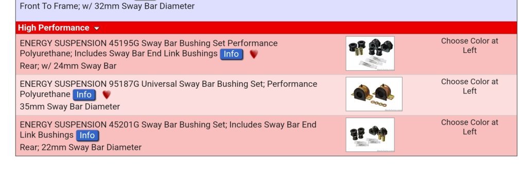

I just bought these from Rock Auto. The front set was 27.99 and the rear set was 37.00. They're from Energy Suspension and were high rated. And the price didn't break the bank. You would just have to find a way to press the old bushings out and the new ones in for the rear bar.

At least the 2010 and newer Performance Package has a 24mm rear sway bar. I imagine the 05 and later PP would have the same if the OP's car has that option. But Dieharder is right measure yours first.

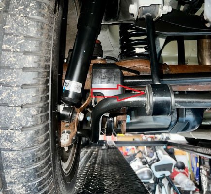

Cut the old out and use a vise to put in the new ones. Worked for me.
Man I'd like to see that. :)
I was thinking about those very bushings and how I would get then on/in the links that attach to the sway bar. No easy feat. Is there a trick to it?
