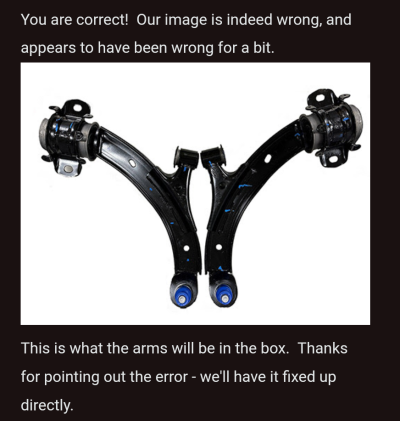

Here are the revised and reinforced Motorcraft arms on Rockauto under 2006 Mustang 4.6. You can compare to the GT500 listing (5.4).
Not a bad price, really. $130 and $148 depending on which side.
https://www.rockauto.com/en/catalog/ford,2006,mustang,4.6l+v8,1432173,suspension,control+arm,10401
I just like buying from LMR, so ultimately I'm just trying to figure out if the revised version is all that's left being made, or if the older design is still out there.
Based on everything I've seen, and other sources from YT, I definitely want the curved, reinforced arms.
What's confusing is that both revisions have the exact same model number, but also the new revision is (sometimes) marketed as stock Motorcraft and not FRPP for a GT500.
If I didn't know better, I'd ask why everything has to be so ambiguous.

Having had both side by side, the new style is much beefier...and heavier.

My suspicion is that Ford may have stopped making/buying the older style arm. Maybe they are just buying/selling the later arm since it works for all 05-14 Mustangs and install either early or late ballpoint and stamp them with a number reflecting that (hence the 7R number on the obviously heavier arm in the pic posted earlier in the thread. What number is on the arms listed as 10-14?).
The aftermarket companies seem to be the ones invested in their 05-10 arm stampings and still produce them.
The Motorcraft arms should have the low friction ballpoint and higher durometer bushing. No guarantee the aftermarket will do that in their arms.
A call to LMR should get an answer.

I agree the revised arms look (and, according to others, are) beefier.
I try to stick with OE parts when I can, unless there's consensus that aftermarket is just better/as good & cheaper.
I've emailed LMR, and will post my findings. If I don't get a response, I'll try calling them and see if someone can send pictures of the part itself.
